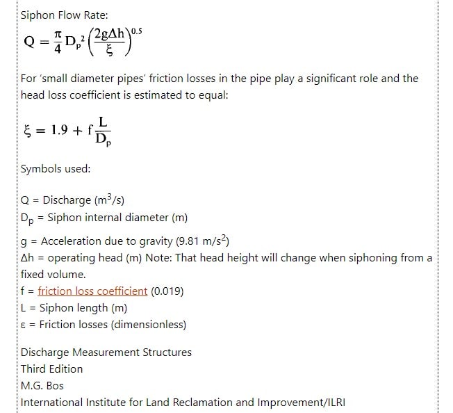

If i use the siphon flow formula from the WWPS (54.56) i get a flow rate of 22.4 l/s, using this formula:
so surely we shouldn't be calculating the flow rates from point A?

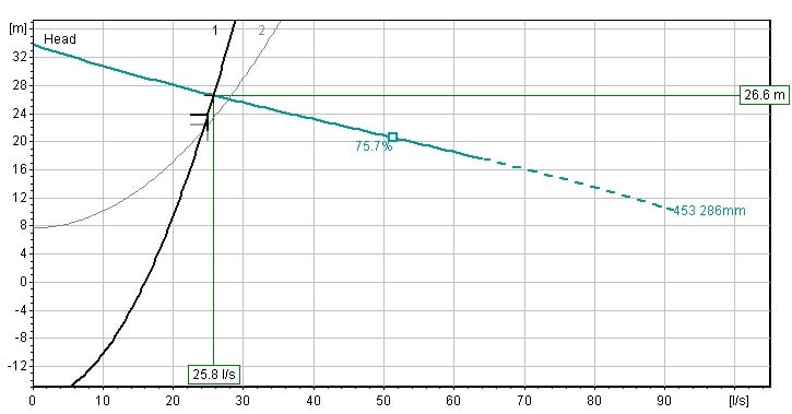

This is the pump and system curves for the two locations (A=2, B=1)

What my line shows is that if you want to maintain a full pipe system you need to have to create, over the length of the pipe, a head of 39m. This is complicated a little by the fact your start point is 16.6m higher than the end point so the requirement is then 23m when measured from ground level at the entry point.
Katmar has estimated 36l/min is needed, but used a slightly longer pipe .
I used your figures in the various posts above and might have got these wrong, but the basic principle applies. Looking at your system curves, I may have misinterpreted the earlier figures as I didn't have the system curves to view and yes, it seem that if these are correct, to generate the required head loss per metre to create a full pipe, you need to be doing more than 23-24 l/sec, which if you're flowing at closer to 26 l/sec, you have enough flow, head and pressure drop to create a full pipe flow.
You don't have much margin here though and a few metres here or there makes a lot of difference.
But in any event, why would solids settle on the down hill section when you're flowing at 1.4m/sec?
What that system curve is telling you is that up to ~24l/sec, you pumping head is driven by the initial static head plus friction losses in the section from the pump to point A
To the left of that intersection point between 1 and 2 you can effectively see that the top of the liquid column in the pipe going to point B gradually rises ( just extrapolate line from point B back to start point using your curve. - so e.g. at 20l/sec the top of the liquid column going downhill would be at about elevation 57 or 58m)
At the intersection point of the two curves, you now have (just) full pipe flow along the entire system.
At this point the friction effect of moving fluid along the whole length of the pipe takes over so your curve 2 beyond the intersection point is no longer valid and should be deleted.
Now you're running a full pipe, look at curve 1 only.
So the intersection point with the pump curve gives you your 26.6m @ 25.8l/sec
