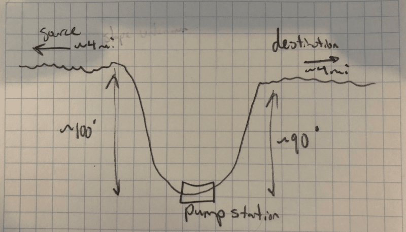

Working on a project to install two pipelines, freshwater and produced water, going 10 miles from one atmospheric pit to another. They don't mix if course. It has been determined that a booster pump station must be installed at a midpoint which also happens to be at the bottom of a hill/draw/whatever you'd call it. This is due to access. There's about 100' of height before the booster pumps, then about, oh, 90' of height after the pumps. I did my best to convince folks that we should put the station at the top of the other hill; seemed to make sense to me, but employee access (there's no easily accessible road to the other location) was more important.
My concern, not having done any of these in this type of location, is the velocity and momentum of the water coming entering the pumps. Could the water somehow rush ahead, possibly vaporize, cause cavitation, etc. issues at the pumps? If the pipe does, in fact, stay liquid full, does the speed of the pump have a factor at all with reference to boosting the pressure? Is this no different from any other pump install, with the exception of having more NPSH available? I feel like I'm overthinking this but I just believe, common sense (I hope), that having a gravity fed pump like this has many more considerations than just the discharge pressure to get the flow back up the hill and to it's destination. I'm not confident that the engineering company that did the hydraulic assessment did much more than just determine the pressure required at the bottom of that hill to get the water to its destination.
I am aware that I would need to preform a surge study to determine the pressure surge at the pump station should things get shut down suddenly, or blocked in.
The pipeline is about 10 miles long. Flow rate is around 35,000 bbld through a 10" poly line, SDR9. We'd like to keep the pressure below 200 psig; it's a comfort level thing for the guys I suppose. I need to refresh myself on the required flow so that might not be the right number. Just getting back into the project...

Can you post a profile so we can understand this. I'm confused as to where this 100 ' and 90' and the elevation of the start and end points are.
Also can you describe a bit more how you plan to start and stop this system.
Booster pumps like this can have some specific issues, but at the end of the day it's still just a pumped system of some sort that needs to be designed. Depending what your static pressure is the pump inlet may need to be designed / specified a bit differently, but not too much of a bother.
Something like that. Even more fun is the system needs to be bi-directional, so we'll be pumping either way through either line.

There are a few issues here which you need to address.
The first is the hydraulic profile of your line, initially in operation with one pump and then with the booster pump.
Being what appears to be a valley on a flat plain? you have an issue with pressure. Your 100 ft valley equates to about 45psi out of your 200 available. So you might end up being limited by this pressure.
Then when you're working out the hydraulic head line in booster pump mode you can't run your hydraulic line direct to the pump inlet, but to the top of the hill on the inlet side(s).
Series pumping with the pump in the middle requires the pumps to be essentially equal and even then you need to be able to control pressure and flow from each one so that the system doesn't become unbalanced.
If you maintain a fixed back pressure at the booster pump equal to the depth of the valley then you won't have any issues with water rushing or breaking away.
The key is in the initial design and hydraulic assessment. Your flow rate given seems to be with the booster pumps installed from a quick assessment I've done and accounts for the pump location in the valley, but it's very tight and needs confirmation.
The other issue you can get is booster pump start creating an initial over pressure and then tripping the pump due to high pressure (assuming you have a high pressure trip). To start the pump you might need to either run it as a soft start / VFD, control the pressure with a valve for a short period or accept the short term over pressure.

Excellent points, and a star for you of course. We've got one other install with a similar setup, boosters in the middle of a pipeline from point A to point B. However there isn't nearly as drastic a difference in elevations. This company uses very little in the way of automatic controls but VFDs were a part of the install; that's how they matched up the curves so to speak. I think you've nailed what I need to cover, and to those still reading I am enlisting the assistance of a 3rd party engineering company. I'm definitely not doing this in a vacuum, but at the end of the day I'm advising my company on the direction, scope, and schedule going forward.
It isn't a flat plain, but this is the most drastic drop, and as much as I wanted to put the pump station on the side or top of the 2nd hill (going left to right) we can't access that location easily, roads and all. I've modeled the system in both VMG (now called Symmetry) and PIPESIM so I'm confident about the pressures required to meet the flows, and where a boost is needed.
