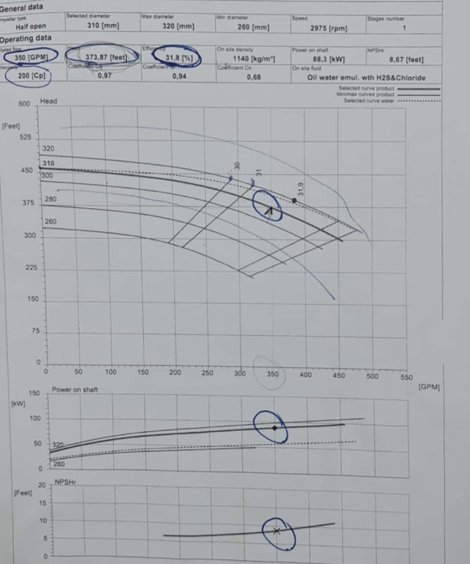

data taken from pump curves:
BOP:
pump A Data is: 350 gpm @ at 370 ft head
pump B data is: 1225 gpm @ 295 ft
I believe the system curve intersects at the above points.

Those seem to be pump rating points.
You end to know actual discharge pressures of the pumps.

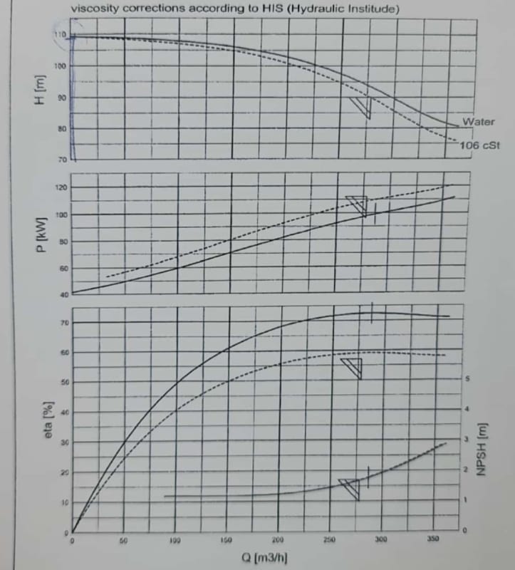

attached are the pump curves

those BOPs on the curve are based on the system curve at the given BOP flow rates on the pump curves so 1575 gpm total for both pumps is what i think is happening

BTW what is this stuff you're pumping? The data sheet for pump A quotes an SG of 1.14, a viscosity of 200cP(!) and a dreadful efficiency of 31% It doesn't sound like "oil" to me...
Is pump B pumping the same stuff?
190 psi at an a SG of 1.14 gives me 380 ft head on pump A which seem well within its capability. There's something amiss with the data here IMHO
