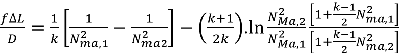

Hi All,
I sized a PSV downstream of a Control Valve for its wide-open failure case and got a 6"Q8" PSV. The required relief rate is 254107 lb/hr with Oxygen as the fluid. The rated capacity of the PSV is 294,851 lb/hr with 10% overpressure. I tried to size the inlet/outlet lines to this PSV. The PSV inlet line is 2 ft long and the outlet pipe is 4 ft long with an elbow. The PSV is to be installed on the 6" line downstream of the control valve with option to move it to the 12" line.
My questions:
1. The PSV Inlet pressure drop should be calculated from the source of pressure, in this case from the control valve outlet flange or can I calculate it from the reducing inlet to PSV Inlet?.
My Calculations : (i) When I used 6" inlet line taking off 6" line the inlet pressure drop is 13 psi, which is 4.8% of the PSV Set pressure. I used AFT Arrow to do these calculations. If install the PSV on the 12" line and use 8" inlet with a 8"X6" reducer at the PSV inlet I still 4.8% inlet DP. Also this calculating the pressure drop from the TEE inlet and not the Control Valve outlet flange. Is there an option that you can suggest to reduce this DP to less than 3%. I can go with a Pilot Operated PSV option whose capacity is not reduced by the inlet line pressure losses. But that is an expensive option and I want to avoid it if possible as the body and trim will be made of Monel for Oxygen service.
2. For the outlet side, I used a 8"X12" expander, followed by 12" Sch 10 pipe that is 4 feet long and calculated the pressure drop to be 7.2% of the PSV Set pressure. The velocity is sonic across the PSV, becomes sub-sonic in the outlet line after the 8"X12" expander and reaches sonic at the pipe exit. I want to know if this acceptable. If I use 10" pipe then the pressure drop goes to 9.5% of set pressure. My AFT Arrow model screens shot for the 12" pipe option is shown below. You can see that even though I want 0 psig at the pipe exit, the model achieves only 0.42 psig. If I use 10" pipe then it reaches 6.7 psig (result pasted as well).
I also did calculations using my spreadsheet using isothermal compressible equation and I get 4% for the Inlet pressure drop and 22% for the outlet pressure drop. My excel calcs are close for the inlet side(4% vs. 4.8%) but there is large difference for the outlet side ( 22% vs. 7.2% ). My spreadsheet is attached also. I did this to cross-check AFT Arrow calcs. I wanted to understand why these are so different.
12" Outlet Pipe Option
10" Outlet Pipe Option:

Hi Snickster,
For your piping here is the calculation:
Sonic Velocity c = SQRT (gkRT) = SQRT (32.2(1.4)(1545/32)(2/2.4)(552)) = 1000.6 ft/sec
Where:
c=ideal sonic velocity at Mach 1.
g = gravitational constant 32.2 ft/sec^2
k = Ratio of specific heats Cp/Cv
R = Gas constant = 1545 ft-lb/pmol divided by MW molecular weight
T = temperature when fluid reaches Mach 1 = (2/(k+1))(To) Where To is stagnation temperature = approx flowing temperature at low velocities
The formula that you wrote for the Acoustic velocity calculation is assuming that the temperature at the pipe exit is calculated using T*=To * (2/k+1). But this is based on the assumption that flow is isentropic that is adiabatic and frictionless. The flow is in the pipe is adiabatic but not frictionless so I think the correct formula would be as shown below. Kindly let me know if you agree.
where T1 is the temperature at the pipe inlet(92 Deg F) and T2 at the pipe exit. Since in our case we ae expecting sonic velocity at the pipe exit, Nma2=1 and T =T*. The equation becomes
T*/T1 = (2/(k+1))*{1+[(k-1)/2]*Nma,1^2)}
so T* can be calculated only after Nma,1 is calculated, which I think can be calculated using the adiabatic compressible flow equation shown below by substituting the values.
where,
f is Darcy friction factor,
L/D is the total straight length including the equivalent if the fittings.
k is the ratio of specific heats.
Once Nma,1 and T* are known we can calculate the pipe exit(P) using the formula
P* a *A = mRT*
where,
a= sonic velocity calculated using a=SQRT(gckRT*/M)
A= Area of pipe exit,ft2
m =PSV rated capacity in lb/hr
R = 1545 lbf-ft3/ft2-lbmole-Deg R
T=T*
I am going to use the adiabatic compressible frictional loss equation for my pressure drop calculations
