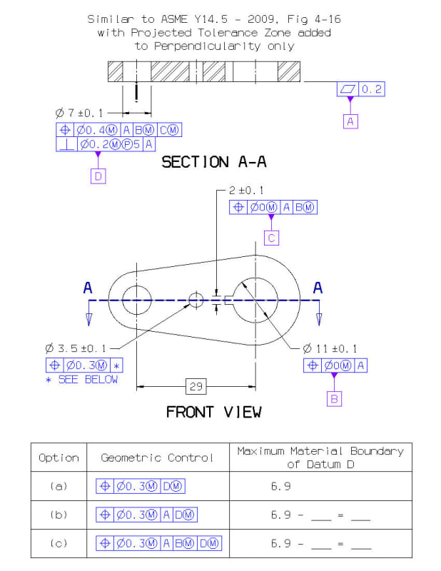

I'm hoping these are fairly straightforward.
***** Image 1 *****
***** Image 2 *****
***** Image 3 *****
***** Image 4 *****

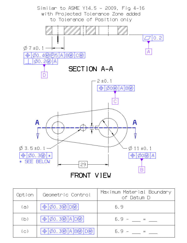

Is there an approach to calculating the Maximum Material Bound when the Projected Tolerance Zone is only used on the positional geometric control or just the perpendicularity geometric control?
I don't see how the starting point will be dia 7.1.
I don't think this can be answered correctly without knowing the maximum possible thickness of the part.
Also, cases 2(b) and 2(c) don't look OK.
3(a) and 4(a) should simply be 6.9.
***** image 3 correction *****
***** image 4 correction *****
That was missed after converting the O.D. of a wall from the ASME example to the I.D. of a hole in this variation.
tim_member, the part thickness adds a divisional branch into the approach. Keeping the PTZ of 5 mm, how would a part thickness of 2.5 mm or alternatively 10 mm influence the result respectively?
Shortly speaking, the thicker the part the smaller the size of MMB of datum feature D. Thickness of the part matters because maximum material boundary of datum feature D resides inside the part (hole), not outside of it, and so its size (diameter) changes as the thickness of the part changes.
I am quite sure that a precise math formula can be found for this relationship.

MMB datum feature references are based on boundaries that are fixed at true position, but MMC projected position tolerances are based on boundaries that are allowed to move. Why would you want to apply both concepts to the same feature? I'm having a hard time imagining a good reason.

By definition the (P) tolerance zone (TZ) is "above" the metal. But the virtual condition (VC) is in the metal. So the VC calculation would use the diameter of the TZ when the (P) TZ is projected "down" into the metal. This would be a reduced diameter. And as you stated the thicker the part material the smaller the diameter in the metal - ratios and all that stuff. Is this correct?
I'm not sure that its being asked that I provide an explanation, however I think it helps me understand the concepts better so here goes.
Per Y14.5.1-1994 the term Virtual Condition doesn't seem to apply to projected tolerances - see section 5.3. What is actually utilized is the "Verification Volume" with a boundary of perfect form called the "Verification Boundary" which exists over the feature height whose axis must fall within the projected tolerance zone, which of course exists over the specified projected height.
The diameter of this Verification Volume is the following:

This means essentially that for MMC/LMC the boundary is of fixed size but not fixed at basic location/orientation with respect to the DRF as we typically expect with MMC/LMC (ie: Virtual Condition) - therefore it can float with respect to the DRF, tolerance zone, and feature. The feature conforms as long as there exists a Verification Volume whose axis lies within the projected tolerance zone and the feature does not violate the Verification Volume. For RFS it is similar to what we expect with a typical RFS tolerance - since the diameter of the Verification Volume is essentially the UAME and is oriented to/makes contact with the feature of interest.
pylfrm - am I correct in my above assessment? If so, can a feature defined with a projected tolerance at MMC be referenced at MMB?

I think I now see that the MMB for the hole is not impacted by the Projected Tolerance Zone.
There is still some confusion on how to take perpendicularity into account when determining max and min shift and how it differs in the various examples.
Ultimately, the desire is to state the location of the pins back to the datum structure that the hole for pressing them into was initially stipulated.
I'm trying to understand the relationship between the hole location before a dowel is pressed into it, and the dowel positioning and orientation after pressed.
This screams RFS/RMB to me. Interference/press fits are one of the few times RFS/RMB accurately reflects the real world mating condition for a FOS. I'm having trouble understanding why your questions center around MMC/MMB - I've enjoyed discussing the topic with pylfrm and it has expanded my understanding of projected tolerance zones, but I'm not sure how it applies to your case.
I think I now see that the MMB for the hole is not impacted by the PTZ.
