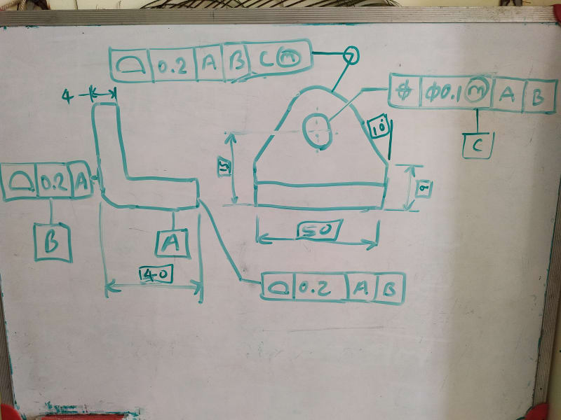

Hi
Design requirements:
Datum B surface shall be perpendicular to datum A.
Hole shall be perp to datum B and located from datum A.
Length 50, 9 height, angular, radius shall be equally separated from hole axes.
Did I used correct GD&T?
Shall I use all around with datum B to control the 4 and 40
"Hole shall be perp to datum B"
Then you may want to switch between the A and B in the position callout to make B primary and A secondary. Any planar surface you choose as a primary datum feature will constrain 2 rotational degrees of freedom and set the orientation of the feature you are controlling, so if you want the perpendicularity to B to be directly reflected by the position tolerance zone and not influenced by how much datum feature B is perpendicular to A, B should be primary.
Another issue is the all-around symbol at the 0.2 profile tolerance which is with reference to |A|B|C(M)|. With all-around, you include the bottom face - datum feature A in the tolerance zone. This doesn't seem to be your intent per the design requirements description.
"Shall I use all around with datum B to control the 4 and 40"
No. That would create a complex datum feature B that doesn't seem to be part of your design requirements. The profile tolerance on the face located at 40 from B and a direct tolerance (if that's the intent) on 4 is fine.
So I will mention point A and B at two ends of length 50 and mention A to B below 0.2 profile tolerance which is with reference to |A|B|C(M)|. With all-around.
Thank you.

it is important as well to look at the form, fit and function of a part.
I take it Datum -A- & -B- will be important to locate on a mating part.
it is important that these surface are square, ask your self why is it important to control profile of the surface?
would a simple perpendicular @ RFS not suffice, with a separate wall thicken tolerance requirement.
as drawn the opposite face of datum -B- why is it important to control the profile of the surface. does it locate an other part?
or it does nothing but for edge distance.
when fit for function of the part is required then do as it is required.
but over tightening of tolerance will require tighter machining and inspection thus cause to be more expensive in cost.
keep it simple, don't over tolerance when not needed. simple dimensioning widths and lengths will simplify
machining and inspection.
just to add I believe the true position of the hole and profile of the radius and angle is a good call.
Your conclusion about the need for the between symbol is correct. Just to make sure it's clear - that profile callout is now with all-around. Once you label the limiting points with letters and use the between symbol the all-around symbol should be removed. The between symbol tells what surfaces the tolerance applies to.
"Holes with true position as well as profile
Will require a CMM."
If position tolerances are applied with an MMC modifier the way it is in this example a fixed size gage of the VC size can be used for the position inspection per the surface interpretation. Once prepared, utilizing a fixed size gage is cheaper and quicker than using a CMM.
As far as profile tolerances go, I disagree that they always require a CMM. For example, if profile control for tolerancing of the small face at 40 basic from B was referencing only B that would be a very simple callout to inspect and it wouldn't require much more than a surface plate, a height gage, and some gage blocks available at every machine shop. This may be adequate enough for the function too.
Contrary to what many think a surface plate and a height gage are not a precise and theoretically correct way to inspect +/- tolerances because this method doesn't provide two point measurements or "actual local size" per ASME Y14.5, but what they do provide is inspection relative to a datum (simulated by the surface plate). Furthermore, +/- toleranced size dimensions require opposed points for measurement but there is only a limited area on datum feature B at which opposed points to the left-hand surface exist. That may lead to a very partial distance verification between the two vertical surfaces. The standard doesn't cover these situations well enough if at all.
