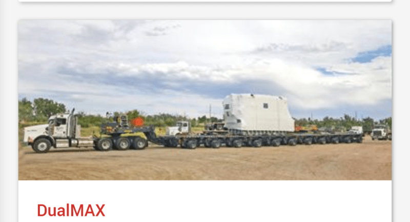

They are all plumbed together, distributing the load. This allows traditional AASHTO calculations to be skipped when supplied with the appropriate analysis. Because they are all joined, at least from front to back, not side to side, when they hit a bump, that one tire group goes up but it also distributes fluid to all the others, causing the shock of the abrupt change to be evened out over the entire trailer.
In our trailers hitting a 4X4 at speed was similar to a conventional trailer hitting a one inch high obstacle. Very advantageous in the warzones it operated as people were around to neaten up bombed out roads and collapsed buildings.
Ours also plumbed the gooseneck to the front set of axles, so the load would also be varied to the tractor, which made trouble for hired tractor drivers as there was also a hydraulic pump to even out the trailer. With the landing gear down and attached to the 5th wheel, the system was capable of lifting the drive wheels off the ground. Failing to get them completely clear of the ground still left the tractor with insufficient traction.
It would not be a problem to handle - simply measure the height of the frame rails before putting the trailer on, then restore that height with the gooseneck to get out from underneath - but drivers for some reason did not do that.
If I take a rope and put many hydraulic jacks long it's length and a load in the center, will the ends of the rope transfer any load to the jacks as they hold the rope straight? I don't see enough rigidity in this system to transfer load.
I am rather sure they didn't make the deck out of rope and they didn't make a design that doesn't work.
If the design is good why is the column on the ground next to the trailer?
The trailers appear undamaged. What it looks like is there are two groups, fore and aft, and each group has a pivot pin arrangement in the center of the group to allow the groups to turn independently of the load. However the load is so long it might not survive being supported solely on those cradles, at least on the highway, so additional cradles are added farther fore and aft with slide plates to slip back and forth on the deck.
The accident occurred where they were moving from a 4-lane to a 2-lane section of highway, so they would be shifting the groups from the right most lane to the continuation of the left lane.
If the driver of the rear group used only a crabbing motion rather than turning, that could have put the rear slide cradle off the edge of the trailer, pulling the rear side cradle with it, as seen in the photos.
I presume someone thought that making 2 groups would allow more maneuverability getting out of and into the original build site and the final installation site respectively, places where the lack of large loads or harmonic vibrations could allow removal of the slide blocks.
Other places said it took 1.5 lanes and it may be the driver coming the other direction saw the truck come far over the centerline and tried to make it to the open, right, oncoming lane. It's possible the rear driver saw the car and panicked and crabbed to avoid scuffing the tires on the trailer, dumping the tower on the car.
