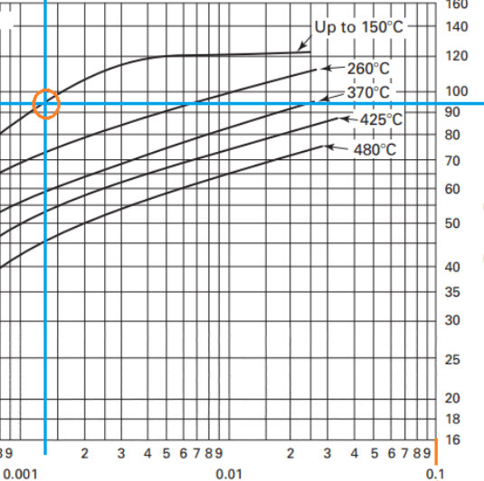

Could you explain plz how to get factor A 0.00140 in above figure?
Just a little bit to the right of the blue line?
Looks like you're right at the interesting point where a small change in one axis makes a big difference in the other axis

Distance between vertical lines after 0.0001 and 2 is 0.5 Or 0.25 ? Some vertical lines is not same in length but add 1 , some lines is not same in L between them but also add 1 unit
Is there in Asme code mentioned in specified table this values fir factor b like exemption impact testing at temp in b31.3 tabulated
The vertical line at 0.001, just to the right of 0.0009 is exactly that - 0.001
The next line to the right is 0.0015
Then 0.002
Then 0.0025
then 0.003
then 0.004 ...
don't know about your second point
Thanks but So very difficult intrapolate for me , i could not never centralized my brain on it
Last question , is there any table that specify A or B values?
Didtance between two lines 0.001 And 2 ( after that ) and lines between 2 & 3 not same len , confused !!!
In following figure factor a considered 0.0014 (blue line) my question is factor A at factor b=90 is 0.0013 ? also factor A at factor b=100 is 0.0016 ? So the factor b at factor a=0.0014 = 93.3 or greater???

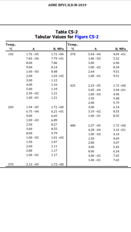

I found tabular values after finishing the charts for temp 150 degree and factor A=0.00135
1)Column B for factor 2 is 84.8 and for col B factor 3 is 103mpa?
2)using the chart really definition of values is difficult.how you calc without tabular values using only charts , if read the chart factor b is 13600 if use tabular values like above factor b is 13200 maybe 13220 , theses difference no problem????
