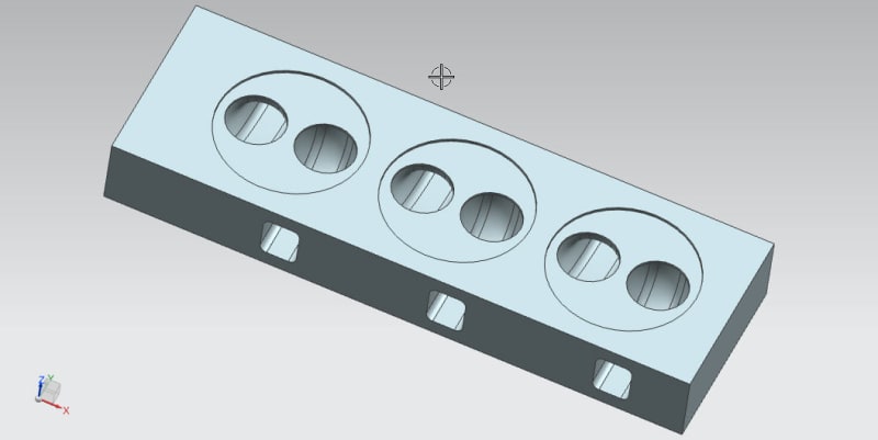

I want to create above type of shape in Nx 11. To create this I have created two sketches. No guides are provided to do so. The cut should be normal to profiles. I am attaching the file where I have drwan everything but stuck at creating the above shape. Please help me in this regard.
Thanks Kneubaecker for the reply. As you know I am unable to open NX 12 file so could not understand the total process. I created perpendicular lines on the Rectangle end but how to create perpendicular lines at circle end.
Thanks once again. You did not mention the value of d. Is it a linear dimension.
You can make D what ever value you want. I created an expression called D and used that for the value of all the dimensions. You can now just edit the expression D and all the points will move. You may find that you do not want them to all be the same and you can just place individual dimensions. You will have to try different values to find your optimal result. Yes D is a linear dimension.

Thanks a lot, Kneubaecker with your help I was able to create what I wanted.
