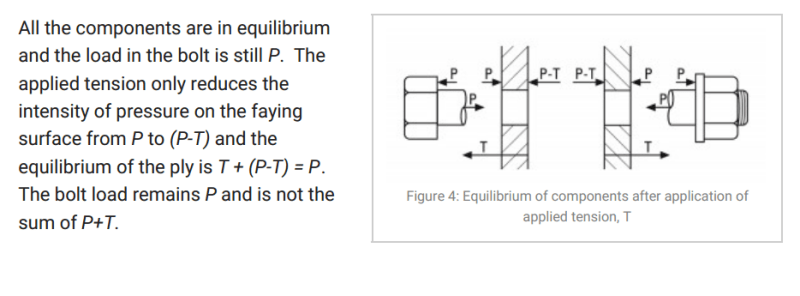

Well, in the contrast, I don't see any tension load from the hanger added to the pre-loaded bolt because the tension load actually just occurs on the plate surface in the area around the bolts (pre-loaded area), the load path is different from normal bolts.
This time it appears I'm the one who was partially incorrect. I was thinking the force between the underside of the nut and the plate (and therefore the total force on the bolt) would be P+T, but Istructeuk's diagram showed the flaw in my thinking. Until T exceeds P, the force in the bolt is just P, regardless of whether the force is applied to the bolt or assembly.

I agree when you load a bolted joint there is an increase in bolt tension, however most of the external load goes into the clamped components to reduce the compression of the faces.
The load is proportioned depending on the stiffness of the bolt and clamped components see this link
"The load is proportioned depending on the stiffness of the bolt and clamped components..."
It seems as if we've been oversimplifying it a bit. I have to agree with desertfox's statement here. Strain compatibility would dictate that there would be at least a small (granted, typically very small) increase in bolt stress when compression on the plates decreases, since the bolt has to elongate ever so slightly to accommodate the elastic 'rebound' of the plate thickness with the reduced compression stress.
