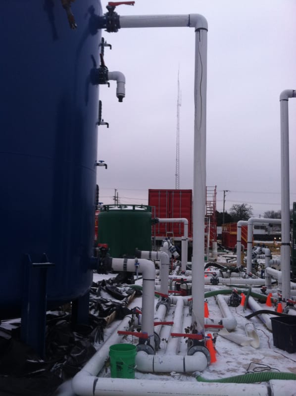

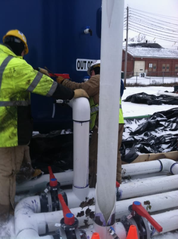

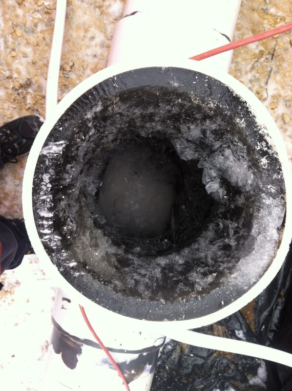

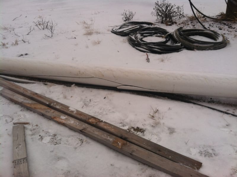

Here are some pictures of frozen piping. The client insisted on keeping this outside piping on standby until the last minute with winter rapidly approaching. In addition to your scenario, there may be instances when the entire pipe freezes causing expansion. I had a project some years ago when the equipment was not operating (and blocked in) and a very quickly moving severe freeze occurred. As you can see from the pictures, the entire pipe froze which split almost the entire PVC pipe. The third picture shows the entire pipe split and fell off leaving an ice core.
