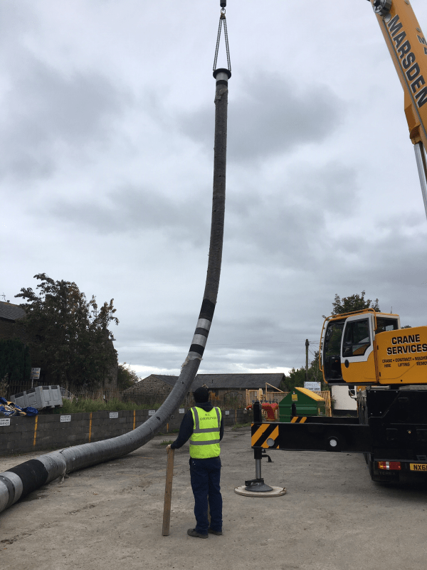

The biggest issue I see is static axial load on the hose. I assume when filled with water the hose sinks and therefore 700m hanging off the boat will end up with a significant axial load??

It is nice that your equipment can handle the weight of the hose, but that is not the concern. Can the hose handle the weight of 700 m of hose hanging from one end. Fortunately, it is in water and the buoyancy forces will reduce this weigh considerably.
OK, hope it works out.
My point as composite pro points out is not the load per se, but whether your flexible rubber riser has sufficient axial strength capacity.
It is not an uncommon service, but there are "risers " and "deep water risers" and hoses.
Not all the same thing.
Also see what happens to the riser when you add 70 bar pressure in terms of shrinkage. You don't want this force to add to the weight of the hose. Most flexibles have an effective Poissons ratio much higher than steel and over 700m the reduction in length can be considerable.
Thank you both, the calcs on the weight are higher in the thread. as has been stated a hose full is better than a dry pull. WE have burst many hoses on tests both dry and wet and burst by pressure, end tensile is normally quite close to the equevilent to tensile at burst in the hose we use.
Spiral wound or braided will hold the load with a good ratio of safety.
I know some riser are made to stretch to compensate for ship heave and break-aways are always fitted.
