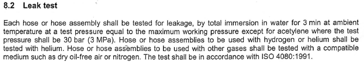

ISO 14113:2013 Gas welding equipment- Rubber and plastics hose and hose assemblies for use with industrial gases up to 450 bar (45 MPa).
These standards do somewhat inspire the internal standards for a lot of the major gas plants in Europe, but is severely limited once the cylinder pressure exceeds 285 bar cylinder pressure. Furthermore these standards are quite limited in their descriptions and practical value and are often disregarded in favour of the gas plants internal standards that they require us to follow. (No american standards has even been taken up - CGA G-4.4 for cleanliness is often referenced but is deemed insufficient for a lot of europeans gas plants, and require the old Praxair GS-38 standard to be followed).

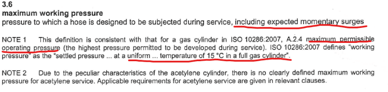

Take ISO 14113:2013 as an example:
Where the maximum working pressure is defined as:
Now this is where the point of some confusion begins. The first line would indicate that the leakage test should be set to the maximum surge value, which is fair. But NOTE 1 clearly indicates that working pressure is to be defined at a uniform condition at 15°C and during service.
This standard is for hoses used to connect industrial gas cylinders to manifolds and bundles prior to any reduction stage. Note, not filling stage. During the usage stage the surge is limited to 315-320 bar pressure. So per the standard the leakage test pressure is usually set to 320 bar, and alot of our customers only demand testing at the nominal cylinder pressure at standard conditions (300 bar).
"Your definition of maximum working pressure drifts all over the place from 300 bar to 415. what exactly is it?" - My apologies for any confusion in my previous answers.
Lets take the 6 mm double braided kevlar reinforced hose as the example for pressure specifications:

"Why is pneumatic (leak) testing set so high. Chemical piping to ASM B 31.3 regards leak testing as Design Pressure or 1.1 x DP at worst. Why 2? Or as your reply says 1.5 to 2 - which is it?" - See above note. Hydrostatic is minimum 1.5. Leakage (pneumatic) is set to 1.0 maximum working pressure. Now the question is if you define maximum working pressure as the nominal cylinder pressure (300), or the maximum allowable working pressure (415). I have yet to meet anyone who demands the last one to be performed, only the first one.

In respect of item 3.6 that you list, my interpretation is different.
The first line is as you say quite clear about the definition of Maximum Working Pressure.
Note 1 though just states that this is consistent with the definitions used in a different code for gas cylinders and does not IMO alter the definition in the first line.
The third line in your bullets I think is better just called Working Pressure or maybe Normal Working Pressure
In piping codes there is sometimes Maximum Allowable Operating Pressure and then you can set Maximum Operating pressure to MAOP or lower, with sutable protection devices, relief valves etc set to protect at MOP.

Update: I reached out to some individuals that I know is part of an ISO technical committee that oversees parts of the industrial gas industry to see if any applicable standards are in the works, and would you know they actually answered!
"A new standard is set to be proposed in 2025/2026 describing gas cylinders and flexible hoses assemblies - Specification and testing"
"Strength test should be an hydrostatic pressure test set at minimum 1.5 x PR, PR=PW x 1.25, where PW= nominal cylinder pressure"
"Leak test should be an performed at PR with an allowed leak rate of maximum 15 cm^3/h as a result of peak pressure spikes and temporary polymer creep"
In reality this would mean for a 300 bar hose should be tested at: PR=300x1.25=375 bar (Pneumatic) 1.5xPR= 1.5x375 bar = 562,5 bar (Hydrostatic). Which is doable with some moderate adjustments. I suppose we will have a sit down with our customers and try to unify the requirements for the different hose types and applications (emptying, filling ect.) (I would propose trying to implement the requirements in the proposed standard, with the caveat being that these values might be changed before the standard is actually released).
