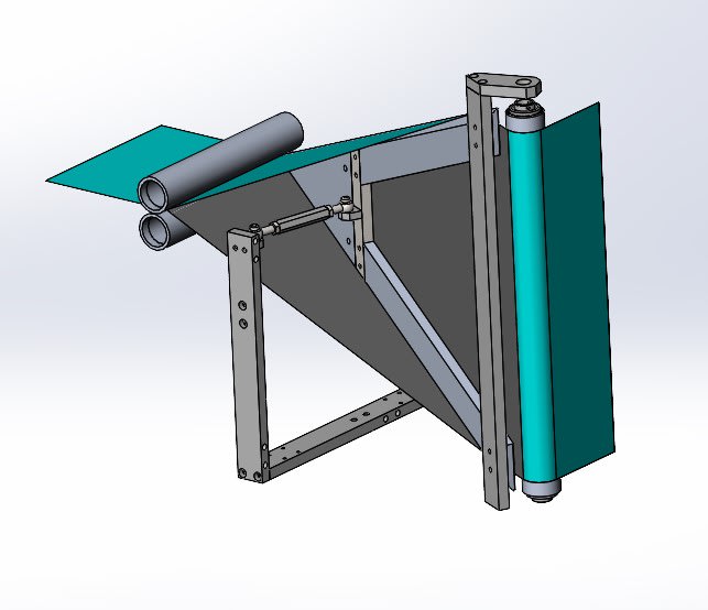

The machine in question manufacturers flexible packaging using various films one example being polyethylene. Part of the process pulls the film over a triangular folding board whose edges can be made from various metals, such as stainless steel or aluminum. We have used various treatments and coatings to minimize friction and reduce wear along these edges, but significant wear still occurs.
We are now trying to find a way to estimate the life expectancy of these folding boards based on the different materials and treatments we use. I have looked at the Archard-Child equation, but it requires knowing the Wear Coefficients for the material pair in question which I have not been able to find.

A picture of the process would help
What is the number of cycles before wear is unacceptable? Is it a cost issue? Did it ever meet expectations for wear?

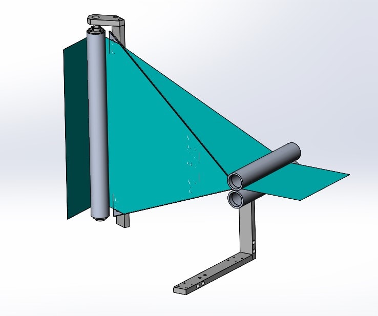

I have attached a couple of images for clarity.
The polyethylene web is continuously pulled through this portion of the packaging line. As the web is pulled over the folding board, the web is folded in half and turned horizontal. The edges of the folding board wear from the continuous sliding of the polyethylene web over it.
We see wear in the field over time and don't expect to prevent it. We do however want to optimize our material selection to minimize this wear and also want to estimate the expected time these folder edges will last before requiring replacement.
The machines can run in excess of 100 fpm 3 shifts a day 7 days a week. We would like to be able to give our customers an estimate of how often these edges need to be replaced.
We do not want to set up a physical testing rig to empirically determine wear rate, at least not at this time. Hoping for an analytical approximation.

This type of process function is often done with "turning bars" or similar. The edges should have very carefully controlled radius so that a layer of air gets trapped between the plastic film and the stationary surface, which acts as a lubricant to create very low friction. A sharp edge acts as a scraper, eliminates the air film, and collects dirt. The contact pressure at the turning surface will be proportional to the web tension and inversely proportional to the turning radius. Air bars fed by a blower can be used where very low friction is desired
Rollers cannot be used because the material is not moving in the same direction as the surface of the roller. This process requires sliding contact.
