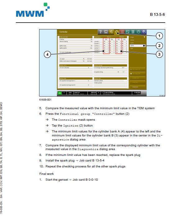

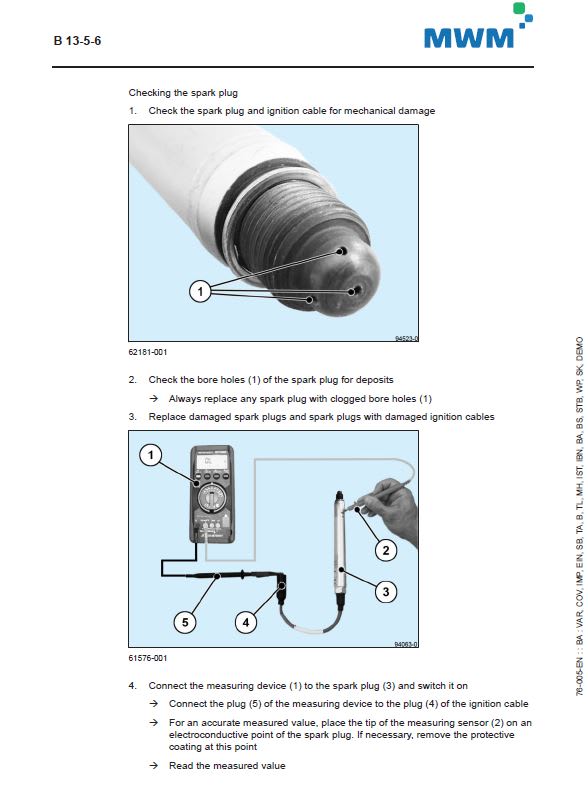

We did get one that didn't make much sense to me. We were told that if the spark plugs pass this test then we cannot get warranty credit for one that fails prematurely. It seems to me that there would always be infinite resistance though unless something crazy happens inside
The external body of the plug is the ground. There needs to be not only high (near infinite) resistance, but also high dielectric strength between the ground and the electrode (which is connected to the lead of the spark plug, 4, in the diagram). Otherwise, instead of jumping the gap in the prechamber to initiate ignition, the high voltage will find a lower resistance path to ground and the plug will misfire. In a plug that is deteriorating in this respect, it will misfire at high load first, and the misfire can progress to lower and lower loads, as the weakened dielectric barrier progressively breaks down.
By the same token, eroding electrodes drive up the breakdown voltage needed to initiate a spark, which can cause the increasing breakdown voltage to find a different path to ground, i.e. puncture the formerly intact dielectric barrier.
