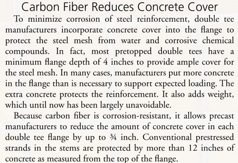

So how thin are those flanges? I assume they are so thin because of the FRP.
I believe garages generally use pretopped DTs with a 4" top flange. A regular DT usually has a 2" top flange and would probably need a cast-in-place topping for a garage. Since the grid would be in the precast it would be lower down with a 2" flange + topping.
According to the legal filing "the DTs were factory-topped by Metromont using a precast topping slab manufactured by Metromont, which used carbon fiber C-GRID® as an alternative to traditional steel mesh.'.
I think Metromont used 3-1/4" thick pre-topped flanges, based upon this older STRUCTURE Magazine article, authored by a Metromont engineer in 2006: Link
