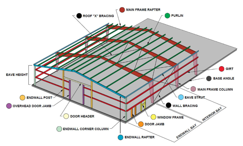

I've designed a few foundations for metal buildings but I don't claim to be an expert on the load path the PEMB manufacturers use. My question is specific to the rod bracing you commonly see in the roof of these structures. They installed some rod bracing that is bent pretty bad. I got a comment from a PEMB supplier's project manager that says these are non-structural elements and are only used to square the building. I had always thought these braces created a diaphragm. Am I wrong?
I'm going to challenge the statement and want something in writing from the PEMB manufacturer but wanted to check here with the experts in case they try to pull a fast one.
retired,

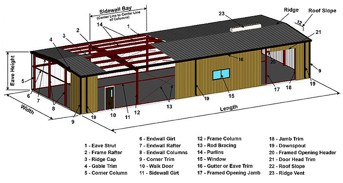

Not to answer for JAE, but your diagram leaves out the compression struts. These are either discrete members, typically CHS, or in the case of smaller buildings, the roof purlins serve as bending/compression members.

PEMB metal roofing, as hokie66 states, is NOT decking and has zero diaphragm capacity. Well OK maybe 1 plf capacity.
The rods do not complement the roofing, the serve as the only lateral diaphragm entity in the roof planes.
There is zero attention paid to the roofing during PEMB lateral design.

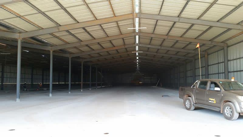

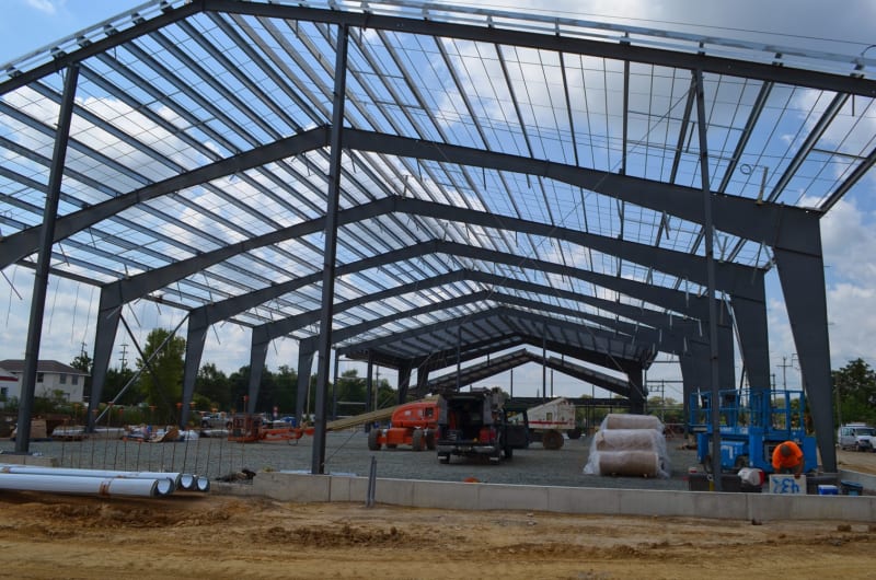

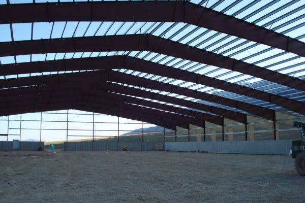

Photos below just food for thoughts.

retired13: The 4th picture you posted must be in an area with really high gravity loads or the frames must have to support a lot of hanging loads. That building is only about 70' wide and 12' tall. While shorter buildings tend to have more gravity load outward thrust than taller buildings of the same width, those frames look really beefy for 70' wide.
retired13: Part of the quote you noted relates to using the roof purlins and wall girts to help strut the rod loads from the center of the roof to the foundation. The purlins/girts have no significant axial capacity in compression unless the panels laterally brace them.
going back to your picture 4, the wind on the bare frames is probably much higher in magnitude than the fully sheeted building. Add to that the purlins being weak in compression and the temporary bracing definitely becomes much more necessary as noted in your quote.

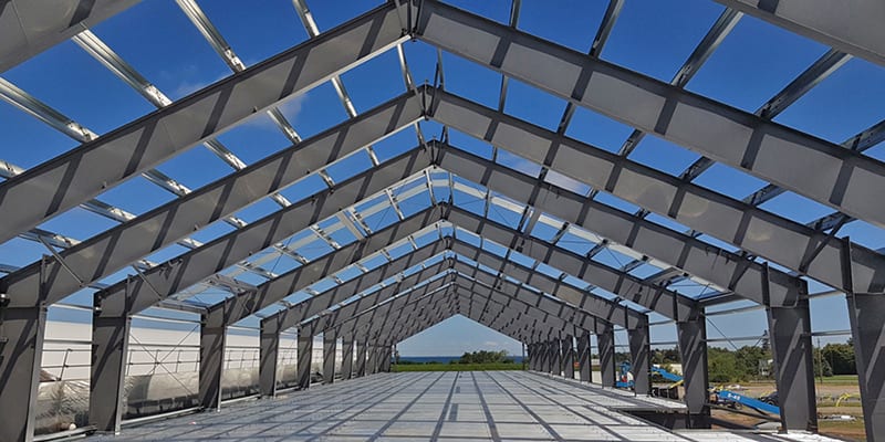

Here is some metal building bracing porn for you:

I agree SteelPE, that is bracing porn. Anytime you have to rotate you head 90 degrees to figure out what is going on, "porn" is the correct term. That is definitely not standard rod bracing. That must be a hanger in the picture.
