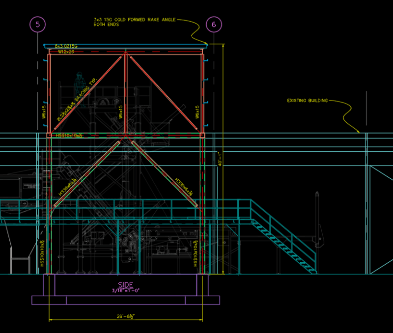

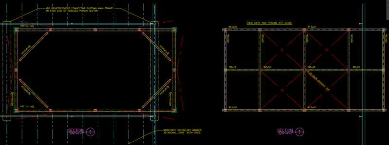

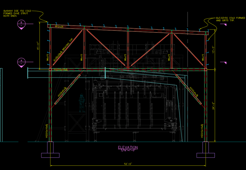

This is a sketch of the direction I am thinking of going with this. (note sizes are not confirmed). Basically planning on building a really skookum HSS frame and then sitting the enclosure on top.
bones206 said:
I've done a few of these in the last couple years. I typically go independent for the new structure, then reinforce the existing adjacent members for snow drift.

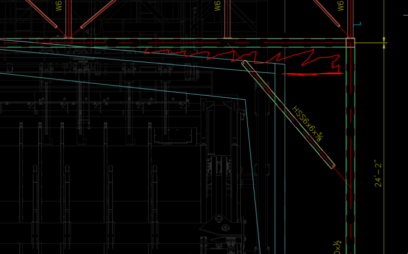

bones206, was there anything special needed to adjoin the metal roofing in this case to ensure there was no leaking or that there could be relative movement between the two? There is one area here where there is going to be a bunch of irregularly shaped spaces that I am going to have to figure out how to fill in somehow also going to try and have a brace coming through the existing wall:

I thought this might be an option here for me to run the cut purlins on each end into my new structure
I may suggest simplifying the longitudinal section by doing a clear span moment frame rather than a braced frame/truss. It should have similar stiffness to somewhat match the drift of the original PEMB frames. I usually let the architect worry about flashing and roofing tie-ins, but it's a good idea to calculate upper bounds and let the architect know what they should accommodate.
For the roof diaphragm, I like to use rod X-bracing. Just because it's simple and cheap, with easy connections.
I don't necessarily see a need to connect the existing purlins to your new structure. You may need a sloped bottom girt just above the existing roof to attach the bottom of the new roof panels.
Unfortunately, I don't have much room outside the PEMB for the foundation pad (there is another storage structure outside beside this PEMB) so I will have to use the braced frame in order to cut down the moment in the foundation so I can reduce the pad size.
unless I can design HSS foundation connection as pinned. But I'm not quite sure how to do that with HSS baseplate having anchor bolts on the outside. Not sure I want to go into that design challenge figuring out exactly how much moment I can get reduced from using a thinner baseplate.
This is my approach for what it's worth:
1) Design column base as pinned for frame and foundation design
2) Design column base as fixed for anchorage design.
3) Apply a rotational spring at the base for frame drift calcs.
You could also consider wide flange columns, and putting anchors between the flanges as is typically done for PEMB's.
Nothing wrong with your proposed design, I just mentioned the moment frame as a possibility. The truss just looks a little on the expensive side and maybe more difficult to construct. Usually one of the constraints on this type of project is minimizing construction duration with the existing roof taken off. So any structural system that can be erected quickly to get the building re-covered is advantageous.
