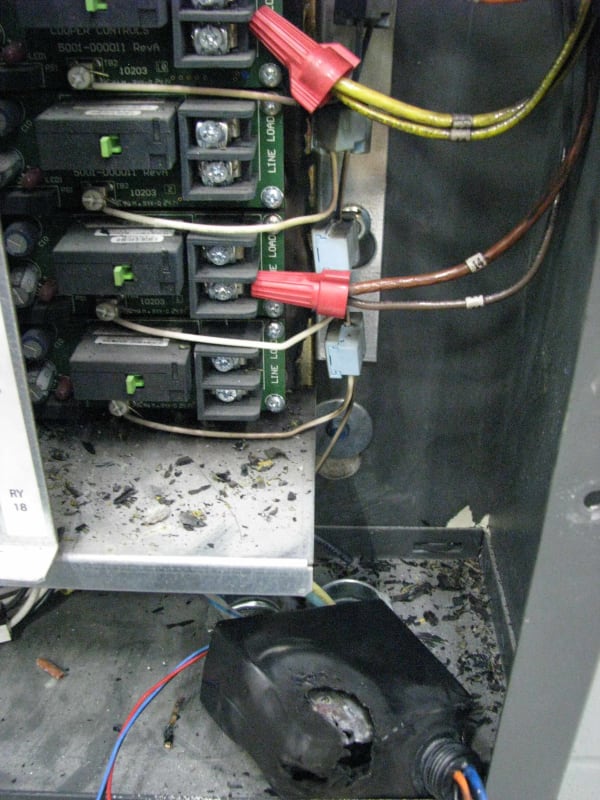

Any idea how a burnt up plastic power pack for a string of 277v LED fixtures can burn up half the relays in a lighting control board and then trip multiple 20A circuits and the 200A main.

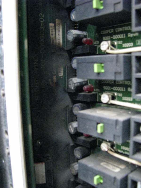

Oh wow. What a mess.
That is exactly what high energy arc destruction looks like with respect to printed circuit wiring boards. Same color I see, same soot patterns. It's what happens when a line-to-line not-bolted arc occurs. It's a dread arc-blast that interestingly tends to blow much larger upstream breakers frequently.
I recently had this happen at a job where a VFD braking resistor was bolted-shorted which connected the VFD's DC bus to ground. The short connected the VFD's rectifier bank from the supply directly to earth which essentially tied all three phases together thru the rectifiers. The VFD rectifier bank completely exploded in a ball of fire that sounded like a grenade going off and it didn't trip the 30A three phase breaking in my hand but did trip the 400A breaker to the building. Similar to your experience with exactly that same soot everywhere.
I believe what's happening in your case is line spikes are violating your lighting gear's voltage rating likely damaging a component, probably a capacitor, and that's resulting in a line to line or line to earth fault. That fault is causing a very high energy arc that's obliterating everything in its vicinity.
You need some form of spike protection ahead of your 'tender' lighting system.
You should also do a survey of your facility looking for anything that could be generating voltage spikes. Things like star-delta motor starters, welders, any large inductive loads. Perhaps large motors. Electromagnets? Large banks of ballasted lamps?
For suppression I'd consider possibly placing a reactor directly in front of this panel and then further placing a power MOV bank between the reactor and the lighting panel. The reactor will protect the MOVs that will protect the panel.
A last possibility is this panel overheating for some reason. Heat causes RAPID capacitor failure and capacitor failures can make this mess.

Thank you - I think the culprit is the power pack (switch pack) in the lower right corner of the photo.
That seems to have overheated and created a ground fault which "somehow" blew up the LCP, maybe the fault rating of the switches in the LCP are not rated for that amount of fault current.
Also there are a ton of LED light fixtures fed from multiple LCP's which are sharing neutrals, this might have created the line to line short like you mentioned after the power pack failed.

I would definitely like to find out what occurred before I replace the damaged boards on the LCP.
Workable plan that. It definitely looks like whatever that is laying on the enclosure floor, took it in the shorts. It's unclear to me what that was or innards looked like from this view. Looks like a cover only? Ohhh wait! I on second look we're looking not at a hole in a cover at the bottom of the enclosure, but a hole thru the back of that thing, at it's fried circuit board?
All the debris laying around is the fragmented back of that device?
Still it's probably an overvoltage issue. Can you relate that thing laying on the bottom to all the soot blowing out of the main panel? Was that directly from The Box or is that further separate mayhem?

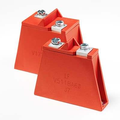

The MOVs I'm referring to aren't your Mom's MOVs but rather these things:
Which are also in products like this.

The item on the enclosure floor is the power pack (switch pack) that is usually installed further away connected to a motion sensor by the light fixtures.
Sorry for the confusion, I added the item in the enclosure for the photo.
The debris on the enclosure floor is the insulation paper backing from the LCP that caught on fire.
Cool MOVs, what is the clamping voltage range?

Hypothesis - the initial fault caused the neutral conductor / PCB trace to go open circuit somewhere near the power intake to that switch rack. The neutral voltage then was free to float at whatever voltage the loads determined, causing over-voltage failure of loads connected the more lightly-loaded phase(s). As loads fail open-circuit the lightly-loaded phase can change, so it's possible wipe out pretty much everything connected given time.
