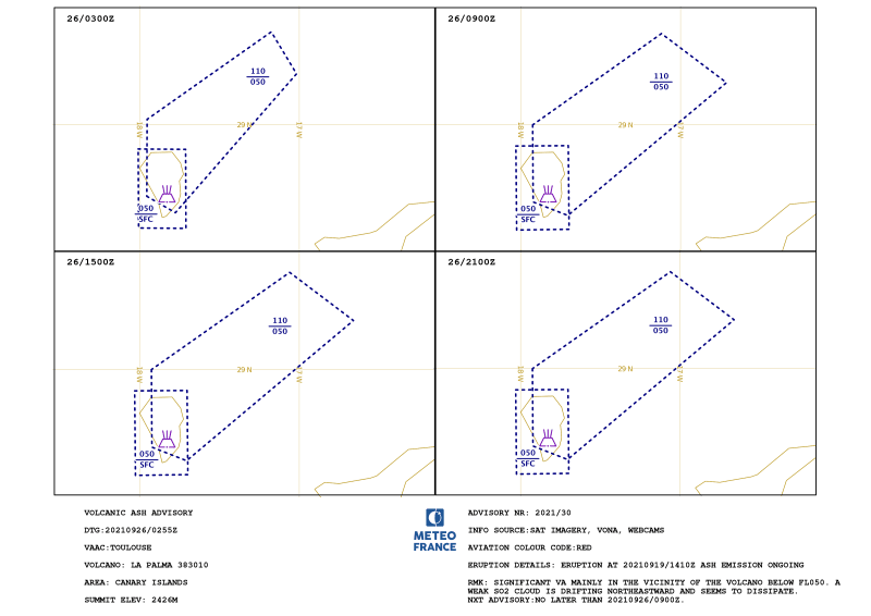

If your interested this is the latest ashtam.

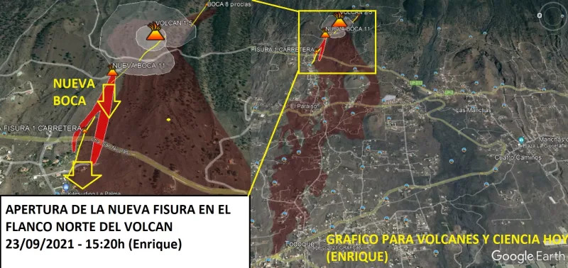

Here's another map hot of the Copernicus press. As of this morning 0708 UTC.
Just heard that the Todoque church tower went down. The frontal lobe is on a slow move again at 30 to 40m/h. Movement on the southern flank has begun again and took out some more houses. 514 Damaged structures and 18km roads.

Airport is in service, but all operators have cancelled every flight. Winds continue to be to the North and a weak SO2 cloud is making its way over western EU.
