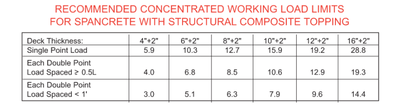

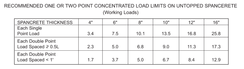

1) The tables below will give you an idea of the ASD punching capacity that you can expect for different systems.

4) Note that, if you were to grout for punching shear, you'd have to grout quite a ways for that to be effective. Punching shear tests on hollow core planks produce failure frustums at pretty shallow angles relative to cast in place, non-prestressed concrete. I'd probably want to grout around the point load something to the tune of 5X the plank thickness.
