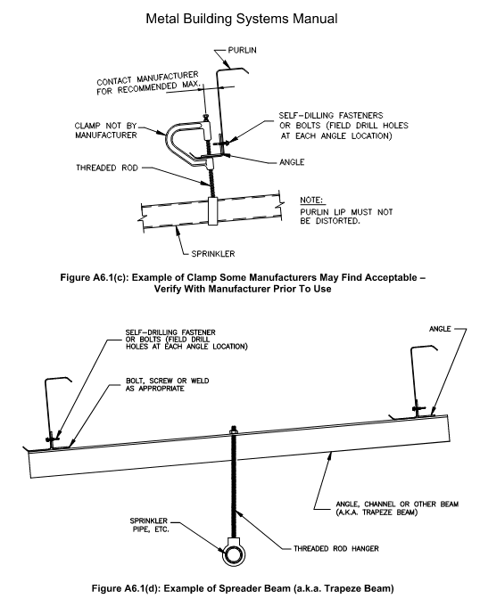

There is structure in which they are going to use it as a training for professional climbers. The structure is a cold-formed mezzanine with C sections. They are going to connect their clamps to the bottom flange of the C-sections. The point load is about 6 kN which can be carried by the sections, but I am concerned about the local failure modes and buckling of the section. Could anyone guide me that which checks I should do on the bottom flange and the section? Is there any sample calculation for the calculation?

The Metal Buildings Systems Manual has some information on this. You should be able to find the 2012 or 2018 editions with a quick internet search. Reference Appendix A6 - Hanging Loads on Purlins for a couple of possible details and tips on what to do or not to do. Attached is one of the recommended details.

@rb1957 the thickness is 3 mm with 85 mm width. The static load from a hanging person is 1 kN, but the load will be 6 kN when they fall down and the rope hold them by the emergency break. Yes, indeed, having an extra element can help there.
I think the best is to have a double section to apply the load in the centre and transfer it to the web to avoid any damage on the flange.
