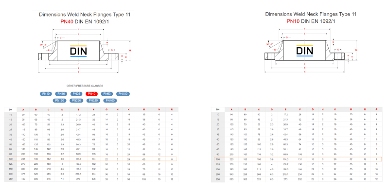

It's a very simple query from a non-piping engineer (I'm automation). We have a tank with an EN 1092-1 nozzle, named K1, of size = DN80. It's annotated as PN10.
I have specified a differential pressure level transmitter on the tank, but the instrument vendor has indicated, that the lowest PN rating they can meet is PN40.
I was trying to verify if I can mate the instrument with the flange on the tank (PN10 vs PN40 for 80mm flange, dimensionally-speaking).
Can someone confirm, that having two different PN-rated flanges, but of the same dimension, will work?
Thank you!
DN80 PN10 & PN40 Flanges have the same dimensions. Note your pressure rating will be as per the lowest rating PN10.

You are fortunate about this and it may not apply for different sizes. Above DN 80 they vary.
The PN40 flange is a little thicker at 24mm vs 20.
This excellent site allows you to see the different dimensions for different sizes and PN no.

The differences are subtle. I am looking at a valve now, where the piping spec indicated connection to be a raised face flange, PN 10.
The valve body is DN100. It's specified with a PN-10 flange, which, according to LittleInch's chart varies in almost every dimension. See attached snippets.
Are we ok or it'll be impossible to mate DN100 PN-40 flange with a pipe's PN-10 flange?

You're not OK at DN100.
They just won't fit without use of a 5lb hammer...
Don't do it.
Find an instrument which is supplied with a PN10 flange
