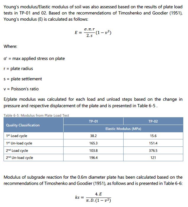

I’m a structural engineer seeking some advice please. I need to do a high level model of a slab on an elastic foundation…apologies as I appreciate this is a structural engineer in a geotechnical forum talking about elastic models…..so to unwritten rules broken already. 😁 I’m trying to see if these is any kind of formal correlation that can be made between the modulus of sub grade reaction and the strain /deformation moduli Ev1 and Ev2. I can find anything so am assuming if there is it’s probably in a far more intelligent environment than Google search…any help gratefully appreciated!
If you know your load and modulus then you can calculate your deflection. modulus of subgrade reaction (k) is load / deflection.
Hi - I understand that the k value is just load/deflection - but I don't have access to the original plate testing results (only the Ev1 and Ev2 values). As I understood it (perhaps incorrectly), the k value is taken from a single (non-cyclical) plate test, whereas the Ev1 / Ev2 values come from cyclical (loading/unloading) tests...so wasn't sure whether they were strictly the same thing, and couldn't find anything that mentioned both k and Ev2 in the same guidance (aside from some esoteric research papers where it wasn't clear if there was a consistent or practically usable relationship). Sorry if being dense - but are you saying that I can simply use the Ev2 moduli as equivalent to k? I've seen this done - but wasn't convinced this was correct. Thanks!
In absence of anything else I would calculate as shown on the attached. I would take Ev1 as E in the bottom equation.

No worries. Ev1 and Ev2 are from repetitive Plate load tests. I have actually never done one myself.
They are different to unrepetitive (or normal as I would call them) PLTs, the main difference being that each load cycle is only held for 1 min.
Regardless of this, K from repetitive is still taken as load/1.25, which is load at 1.25mm. K and E are related through Poisson's ratio etc, so I think its a reasonable assumption to take EV1 as E.
