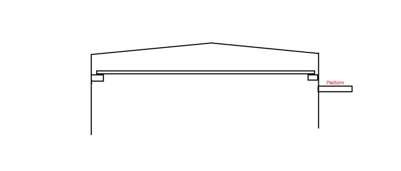

i have a clear span frame with crane and Platform at right side column as per attached.my question is under which load case to include the dead load and live of the platform?
Option No.1:to combine the dead load and live load of platform and put it under collateral load?
Option No.2:to include the platform dead load under case dead load and include platform live load under roof live load case?
Another question please Do we check frame sway for combination (DL+CLL+CRANE)?
