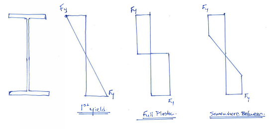

I have measurements and the x-sec and I know that my boundary conditions and material properties are as reasonable as I will be able to get given this situation. My problem is I can calculate a yield load (load when My first occurs) or a collapse load (Mp), but do not have an easy solution for something that is between the two.
I might be oversimplifying this part, but I think calculating the moment value between first yield and full plastic is fairly straight forward, per the below sketch. But I think the real challenging part is (assuming you need to do this) determining at which point in between the two values the beam is at right now. I think you'd need a survey of the beam to determine the deflection along the length (giving you slope and rotation), which should allow you to calculate the current state of stress in the beam. But I'm assuming the point load is no longer applied to the beam, so you'd have to work backwards to determine what load was applied in order to "lock-in" that much stress.
What is the end-game here? Currently you're able to say that the applied load was at least "Y" (1st yield) but likely less than "P" (full-plastic)...how accurate do you need to get between those two values?
What else can you tell us about the problem? Did the section at the fixed end yield, just the one under the load or both? This seems like a complex problem if you want a good approximation and to only use hand calculations, I doubt there's an example in any of the books.
The deformations combined with the yield strain should tell you how much of the section has yielded. From there, if I'm thinking about this correctly, it's a matter of summing the moments as F * A * y, where F is the average stress (equal to the yield stress for the areas that have yielded), A is the area of the section, and y is the distance from the center of the force to the neutral axis./ The center of the force is the centroid of the area for the yielded areas, and the distance to the point where 2/3 of the area is on the neutral axis side (2/3 of the distance to the line of yielding for rectangular sections) for areas that remained elastic.
Edit: I see CANPRO has added an illustration for what I was saying. Just separate the areas at the inside edge of the flanges and the transitions between the rectangular portions of the stress diagram and triangular portions. If your beam is that simple, you'll have just 6 areas to sum the moments from. That should give you the moment at the point of yielding (where the plastic deformation occurred).

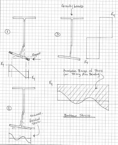

I am looking at an impact on the bottom flange of a beam. The fixed end and pinned end boundary conditions were reasonable assumptions given the beam I am looking at. I am looking at the effect on only the bottom flange to make calculations a little easier.
I am trying to determine how much of the section is currently at yield stress. This is to aid in determining the current capacity of the beam. I would like to calculate the load applied based on the permanent lateral deflection of the flange.
That changes things a bit, but if I'm not mistaken, it actually simplifies it, if only the bottom flange yielded and the rest of the beam is still elastic. If you ignore the small amount of elastic torsional force from the top flange and web that's reducing the lateral displacement, you only need to apply the principles outlined by CANPRO and myself to a rectangular beam and rearrange the equation from the applicable beam diagram in the AISC steel manual (#14 in 2nd Ed. LRFD).
1) Because there is no external load, the locked in stresses in the flange will be self equilibrating. And you can take advantage of that by assuming that, under full design moment, the locked in stresses in the flange would "pull through" and eventually achieve the same stress distribution that would have occurred in the absence of the impact damage.
2) If the impact damage occurred to a flange always in tension, I feel that #1 makes it such that you're good to go: same capacity as the undamaged beam.
3) If the impact damage occurred to an unbraced flange in compression, you can still push through the stress field as with #1 but you'll have to consider the impact that this may have on local and lateral torsional buckling. And I'm not sure that there's a reliable way to assess that without getting stupid-fancy on the problem. If it were me, I'd do one of the following:
a) find a way to straighten the thing if possible.
b) add some new lateral bracing at and near the damage.

KootK, I understand the logic in what you're saying - if the beam is loaded (strong axis bending) the lateral kink in the bottom flange will tend to straighten out as the beam deflects downwards, which will remove the residual stress from the impact. But is there any guarantee that the bottom flange will return to a straight line before it reaches its limits in strong axis bending? As the beam is loaded vertically, there will be additional stress added to the bottom flange from the strong axis bending, but at the same time, some residual stress removed as the flange straightens - I'm not sure how you would compare the rate of stress being added vs removed, but it seems like something that should be checked.
No guarantee unless it reaches plastic moment resistance. And maybe not even then. Regardless, I don't see a negative consequence associated with this outcome for a tension flange.
I'm not sure what one would check for a tension flange. What negative outcomes concern you?

KootK, I don't think I articulated my question/concern very well...in thinking of a better way to word what I was trying to say, I may have sorted it out myself. See sketch below.
Stage 1 is moment of impact, and some portion of the flange tips yield. Stage 2 is when the load is released, the flange rebounds some distance and is left with some residual stress. I was thinking that if the flange didn't return to its true alignment while being loaded in the strong axis, there would be some amount of residual stress remaining that would reduce the strong axis bending capacity. That takes us to stage 3 where the beam is loaded to its full plastic capacity - the side of the flange that was in tension due to previous impact has a limited amount of additional stress it can handle before it reaches Fy, but the opposite side that was in compression can change its state of stress by some value greater than Fy...I believe what you were saying is that these effects cancel each other and we're all good to go.
Precisely. One nuance is that the new residual stress distribution will alter the value of Ix & Iy a bit over the load history of the member. Some parts of the cross section will yield and give up their stiffness contribution earlier in the load history. Others, later. This isn't all that different from the state of affairs with regular residual stresses, however, and I'd not expect it to appreciably affect overall member performance. At some point you just have to accept that everything is approximate and choose to spend your time where meaningful impact can be had.
