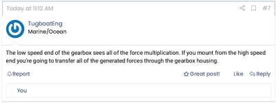

Hello,
I am trying to understand why the planetary gearbox manufacturer recommends mounting his planetary gearbox through the High Torque (Low Speed) side.
I tried to figure out what is the reason, but unfortunately he didn't reply.
A colleague told me I would better mount the gearbox through the High Torque (Low Speed) side, because otherwise "I will transfer all of the generated forces through the gearbox housing", and I am not sure I understood what he meant.
I tried to use a simplified FBD (Force Body Diagram) to analyze the reactions on the gearbox housing in both optional mounting cases (through the High or Low torque side), and it seems that in both cases the gearbox housing reaction would be the same – tangential friction forces (under the bolts' heads) that resist the same torque, no matter to which side it's connected.
Am I missing something?
Thanks!
This is the second time I've seen this question asked here. The gearbox low speed flange is designed to handle all of the reaction loads. It doesn't matter which side you drive it from. You need to restrain your gearbox on the low speed end. The opposite side simply isn't strong enough.
You may be able to get way with mounting from the opposite side of you aren't intending to load the gearbox to its rated values.

I'm just making a quick comment based on the first post. You get a reaction at the mounting points because the housing is trying to turn in the opposite direction of the output torque. If you mount the gearbox on the output side as shown, the reaction acts as a tangential shear load on the fasteners right at the face of the gearbox. If you mount on the other side, the input side, the reaction is still there but it has to travel as a torsional load on the body of the gearbox to get to the face on the input side. A bigger consideration is whether you have an overhung load on the output shaft. Is it connected to another shaft or is it turning a pulley, sprocket or gear? If so, I would definitely try to mount to the output face.

Misalignment at the high speed side will experience many more cycles on the shaft coupling, high-speed shaft, bearings, and seals than the low-speed side. I would strive to provide the best alignment capability at the high speed, low torque end. The housing reaction does not seem that important to me - if the mounting screws can handle the reaction, then surely the housing is capable.

The high torque end of the drive is the one with the highest reaction forces. Even if the housing is strong enough to absorb the reaction loads from the opposite end, more force causes more deflection and deflection reduces the contact quality and life of gearing. So the drive should last longer when mounted via the low speed end, with all other things being equal.
Reason 2: the manufacturer recommended it, which means that's what it was designed and tested to do.
So in summary, in principle I agree with your colleague but I disagree with the conclusion. The most housing load will occur when mounted on the high speed end, so mount to the low speed end.
