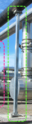

20ft off the ground obviously needs adequate sideway resistance. Even if it is a moment connection at the baseplate, the effective column buckling length is 2x, i.e. 40ft! It probably also needs longitudinal struts to an X-braced bay to resist the friction forces. Otherwise you only have the pipe holding them upright. It will be a major shape just providing the min kL/r.

The pipe may not have side loads or need side bracing but the piping designer should be one saying that.
Oh come on. The pipe is holding the support up, right?
The connections look hinged.
Sure. At the moment the photo was taken, the pipe may well have been "pulling up" the support. Depends on the pipe temperature expansion/contraction moment, and pressure and load condition (empty, vented, full, etc.)
But you are absolutely right: It is the pipe stress engineer who decides where the pipe is, and where the support is and what its loads actually are, under all reasonable conditions of loading, temperature, and dynamic (weather and ice) loads.
That support looks like not even minimum K*L/rx and K*L/ry are meet, even if it was solid steel.
The support in the photo is pinned at both ends and loaded only in compression. The pipe design only requires vertical support at this location. The pinned ends means no frication to consider. The pipe is providing the lateral support to the support.
Thats what I thought. ??? I thought you had earthquakes in NZ. ???
Sure do. There are braced supports and anchors near by.

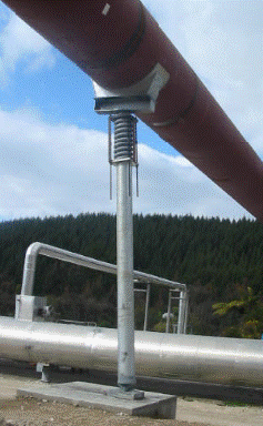

The vertical pipe support in the picture is just acting like any of ten thousands suspended supports: But, when the pipe expands or contracts, the "swing" induced will cause the pipe to lower a little bit across the top of its "circle". The arc of support is only one way though, it will kind-of-sort-of act like a pinned support going left-right with respect to axial flow.
Except it is kind-of-sort-of in compression, until the pipe expands. Then maybe becoming a tensile load when bending the pipe down. And adding more bending moment at center span, instead of less. Interesting concept.
The concerns above can be checked by including the support steel in the stress model.
If vertical movement of the pipe is concern try this,
