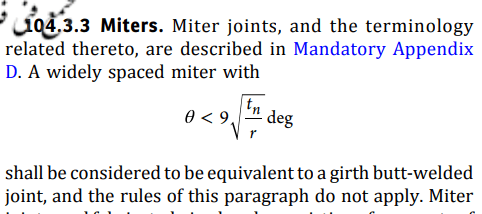

It appears that you want to introduce an angular offset in the pipeline. Similar to Miter bends we compare the allowable angle (B31.1).
So if you have sch 40 pipe then allowable angle is 2.31 degrees to consider the welds as normal girth weld.
So in effect the joint becomes non standard and stress intensification factors etc. needs to be established based on relevant code.
So it is better to reduce the offset angle to be within code limit or break the angle offset in 2 stages of approx. 1.5 degrees each.

Miter bends with angle offsets are acceptable as per B31.1. But in case the angles are above the value given by the above formula the SIF, flexibility factor etc. are to be calculated as per Appendix D but only 90 deg Miter bend values are given. So if the angle is more than 2.07 deg and the bend angle is other than 90 deg then SIF etc. needs to be calculated based on other clauses as per code.
But if angle is less than 2.07 deg then it is regarded as normal girth weld and no special treatment is necessary.
