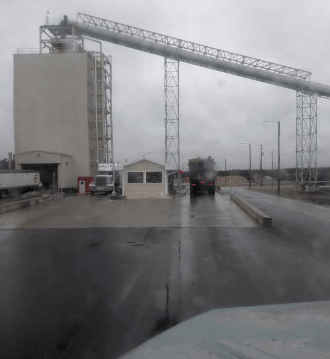

Neat coincidence! I worked at a similar place where we designed/fabricated conveyors, grain bins, and farm structures. We included ice on everything we designed. Loved that job, but they shut down the plant... I'm pretty proud of the one shown below. It survived some pretty strong winds back in 2018 when Hurricane Michael rolled through (although I think it was a tropical storm by the time it hit the thing below).
