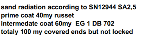

Jan 28, 2025 #1 yazguli Mechanical Jan 4, 2013 38 Hi everybody! Would you please help me to understand the terms in the attached image? Thank you a lot. Attachments Screenshot 2025-01-28 194940.png 57.7 KB · Views: 16

Jan 30, 2025 #2 LittleInch Petroleum Mar 27, 2013 22,567 looks like someone put this through google translate. It seems to say grit blast to SA 2.5, then primer coat of 40 micron, followed by top coat of 60 micron, total 100 micron thick. Possibly with some sort of cut back on the ends or a cap protecting the ends / inside the pipe. Upvote 0 Downvote
