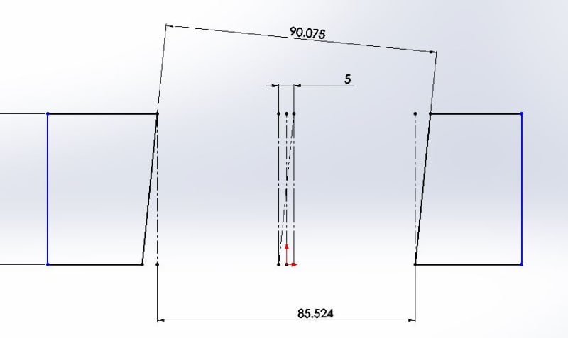

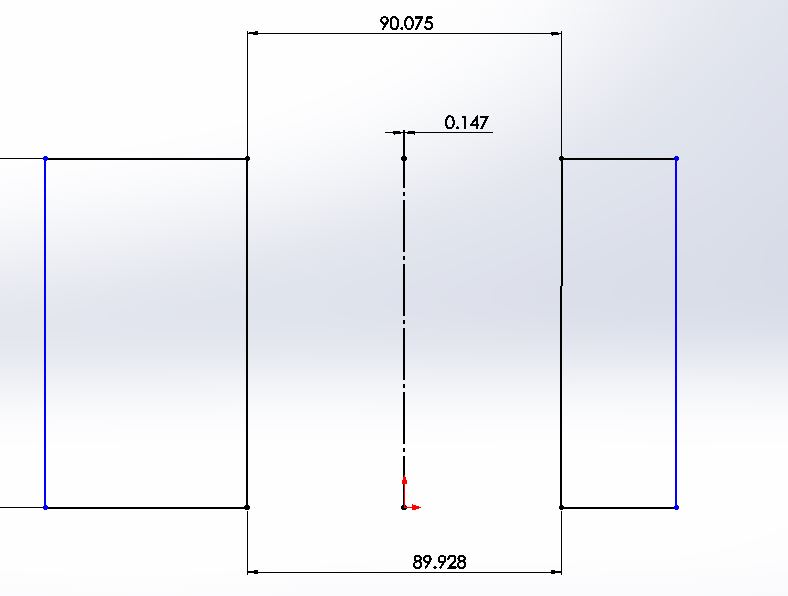

I too have limited ISO knowledge, but even if they don't have the concept of bonus tolerance the calculations should give you a good idea of whats going on in relation to the as produced feature axis. If we assume the 90.075 is the UAME* size and 0.147 is the perpendicularity error of the UAME*, then modeling it out in CAD I get a RAME* of approximately 89.928 which violates the 90.000 boundary. If instead we assume the UAME* size is 90.170 with the same amount of perpendicularity error, then we get a RAME* of 90.023 which would pass. This is why its important to know which is which.

Could you show me a grab of how you applied the perp tolerance in cad please.
I've tried to draw it up and got the same 90.023 but thought I had done it wrong as it didn't tally with the report 90.075.

Alan,
It all hinges on what you assume to be the UAME. If the UAME is 90.075 your RAME is 89.928 (fail vs MMVC=90), if the UAME is 90.170 your RAME is 90.023(pass vs MMVC=90). I didn't include the CAD models because the ratio between the diameter and tolerance zone/orientation error is so high you can't see whats happening without zooming in really far. I included an exaggerated orientation error example at the end to show you what the dimensions are actually attached to.
UAME = 90.075
UAME = 90.170
UAME = 90.075 but ***ORIENTATION ERROR IS EXAGGERATED AT 5.000 INSTEAD OF 0.147**
