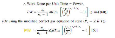

For positive displacement compressors, a more accurate equation is
n_v=gamma=C_p/C_v
R= specific gas constant
m=mass flow rate
T_1=inlet temp, K
Between air and ethylene, the parameters R, n_v, and Z will change. The performance curves need to be modified to take care of the above. Similarly, discharge pressures need to be changed if size and speed are given.
Reference: Compressor Handbook by Paul C. Hanlon
Pay attention to the units. The relation above did not state it clearly.
For SI system consider the relation underneath.
