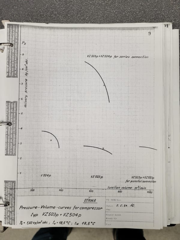

Some further snooping turned up the following curves:
The line of interest would be the short fellow at lower right. Flow looks promising. Outlet pressure is above ambient, so it looks like it might do the job. No indication of how performance might drop off under altitude conditions. It's hard, maybe impossible to figure this out without actual running. I found some literature on the network that said 14.5kpa in suction mode when in a series configuration, which corresponds to about 49,000ft of altitude. Delivery at that inlet pressure is 1.93kg/sec, or about 4lbs/sec. I'm not sure if temperature is being taken into account.

Presume the note below that composite curve for parallel operation which reads VZ503p + VZ503p is a typo error - should be VZ503p + VZ504p.
If one were to make some assumptions on polytropic eff, there most likely is info here on the individual curves for VZ503p and VZ504p to enable calcs to extrapolate performance (approximately) at any desired suction pressure. These are laborious calcs which are made less painful with the aid of a process simulator (HYSIS or Simsci/Pro-II or similar) or if you have means to hire an engineer familiar with such calcs, who may have a polytropic analysis spreadsheet to help. If the results look promising, you could then use these derived observations as justification to request approval of capex allocation for the intended mods. You can also use these calcs to verify accuracy by predicting performance in parallel mode operation to see if calcs match the composite Brown Boveri curve. None of this work comes free of charge, as there is a fair amount of specialist work involved.
