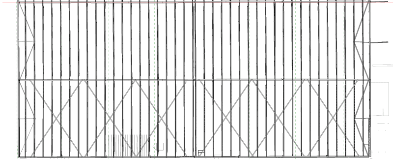

Meanwhile, I had the building laser-scanned and noticed significant frame deformation in the scan model. Looking in plan view, the frame beams at the roof are deflecting out-of-plane in a sine wave shape (i.e., buckling mode shape). The columns are twisted at the top following the deflected shape of the beams.

@Brad805 - here are some images. It's kind of hard to make out, so I added red horizontal reference lines along each frame line and attached the full image as a separate file. All the frame lines in the building follow a similar deformed sine wave shape.

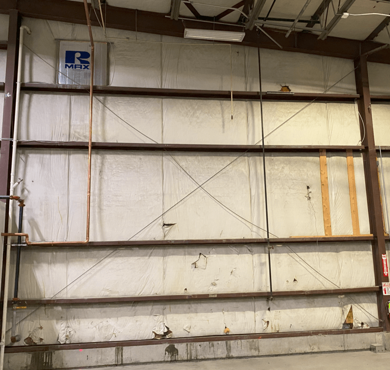

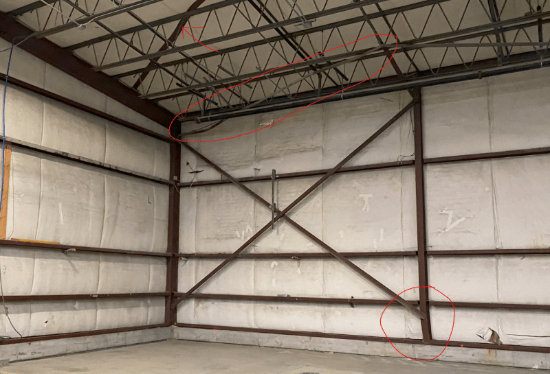

Local distortion at sidewall braces, buckled roof brace, slacked roof flat strap X-brace (although the flat strap probably always looked like that from day 1):
Slack end wall cable X-brace:

Smoulder - I think the scan model is accurate enough to do a rough analysis based on lateral displacements and curvature. I suspect the frame members are still in the elastic range, as these frames likely see significantly more deflection during the shipping and erection process. Less sure about the column twist being elastic, but an analysis could probably reveal the rough magnitude of stresses due to torsion.

bones, in your second pic above it looks like the column is already yeilded at the brace connection, no? Code checks go out the window post yield so I don't know how you'd approach this. Like someone said earlier (maybe you?) you could probably pretty easily replace the end-wall columns (non-frame columns). Frame columns...not so much?
Correct, the column at the brace connection has yielded locally. That is just a wind column, so not hard to repair or replace. The same deformation is found in other wind column to brace connections throughout the building.
