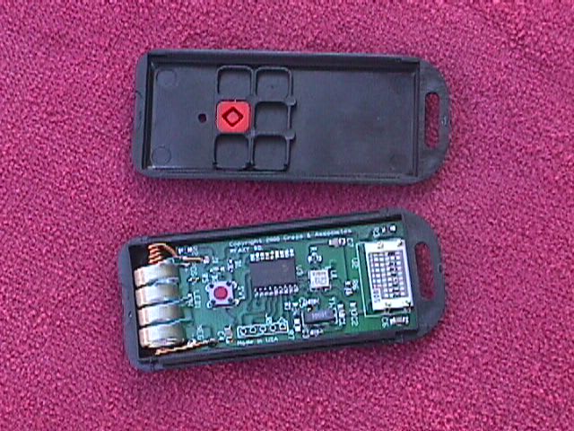

Those pricks! I designed the first system for them and they failed to pay me. The guy offered me stock instead. Then disappeared.
It was even presented on the cover of Popular Science.
