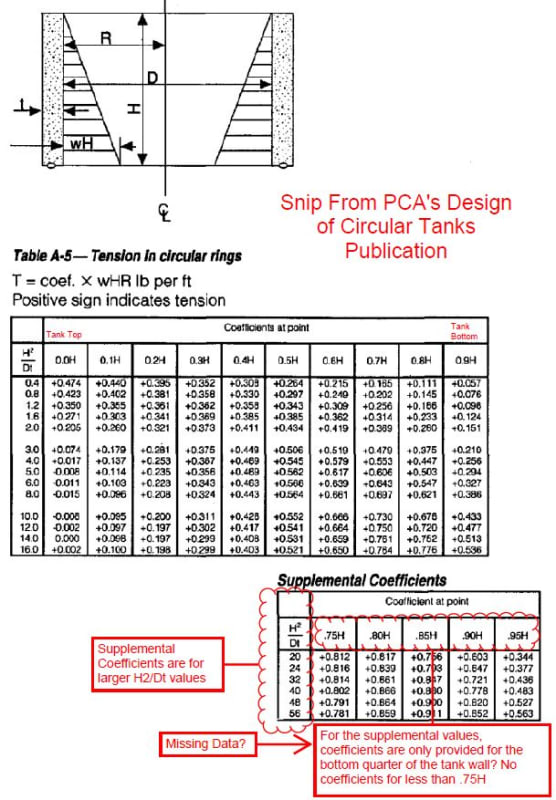

PCA's Design of circular tanks contains many tables for ring tension, shear, and moments of circular tanks. The tables present coefficients based upon the tank height.
These tables are all based on a Parameter "H^2/(Dt)" (tank height squared divided by the tank diameter and wall thickness)
At some point over the years, they expanded their original tables with supplemental coefficients for larger values of H^2/(Dt).
The supplemental coefficients are not for the full height of the tank though. They only cover the bottom 25% of a tank's height.
Does anyone know why? I searched the design manual and cannot find any discussion.
See below examples of the tables...
Thank you in advance.

I always assumed that for higher than .75H, the hoop stresses apply. The fixity of the bottom doesn't make a difference.

The tables weren't expanded over the years. The same tables of supplementary coefficients was included in the 1943 edition, but they also included the following footnote: "For points not shown in the supplementary tables, ring tension and moment may be determined approximately by sketching curves similar to those in the text." For larger values of H^2/Dt, the coefficients at the top of the tank don't vary much so it doesn't appear to be an issue.

Conceptually, I agree with JedClampett. On tall-skinny tanks (large H2/Dt value), the fixity at the bottom has less and less of an effect as you move upwards. At some height it just reverts to pure hoop tension.

For a tall cylinder, simple axisymmetric hoop stresses dominate the behavior, except at the base. I think Jed said the same. Apply moment coefficients for the lower wall height = Diameter to determine your vertical wall dowels, then use minimum vertical reinforcing above.
