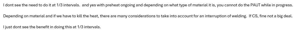

Hi everyone, the pressure vessel body is about 300mm, welded with a narrow gap joint design. Can one-third, then two-thirds, and finally all welds be PAUT or UT tested?

Why not use a measuring tape to take a photo?
What is your role in this project? It looks like you're a student or a visitor.
Do you think the manufacturer doesn't know how to inspect this weld?
