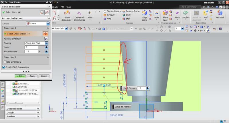

Im trying to pattern the curve shown in the imgage. However, i would also like to decrease the size of rectangle from right side as it goes up. Is it possible to be done in sketch pattern?
Thanks.

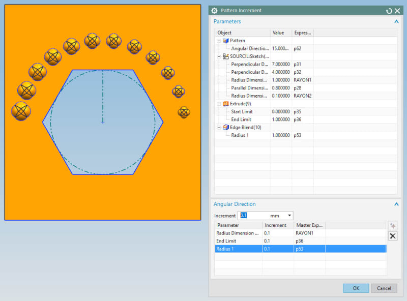

Not in sketch pattern but with pattern feature by using increment option
Find attached an example
