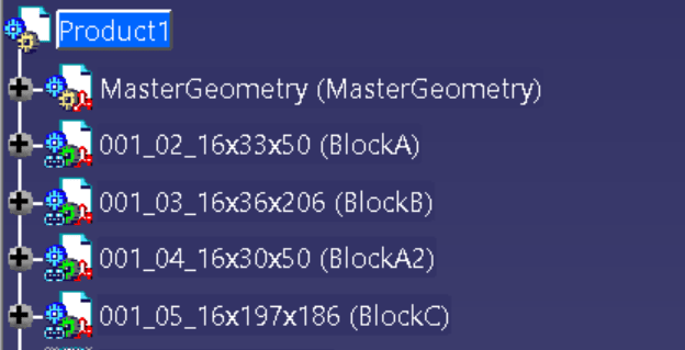

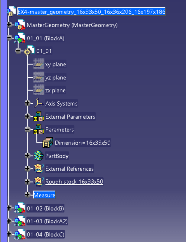

Hi I'm a junior designer and still new with CATIA Automation. I wrote a cat vbscript to rename my part once it has a new parameter "Dimension". The part number shall have additional Dimension.value into the name. As per image below I want the part name to become '01-01_16x33x50'
somehow my code doesn't work and i'm clueless why

So based on the revised code, the code catch all the "Dimension" and rename the product level:

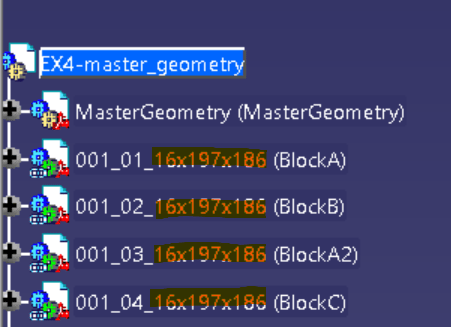

But now I'm facing problem with the 'StrParmValue', based on the image below look like the dimension is looping and end on the last dimension resulting in the part name to be like highlighted.
I'm still learning to see if i can use 'do while' instead but if you guys willing to enlighten me on this. I'll be grateful.
hi,
I'd loop thru the parts of your assy:
get each part's Dimension parameter (e.g MyPart.Parameters.RootParameterSet...)
rename the part accordingly,
move to the next one
if you have a nested structure (i.e assys within assys with parts that you want to rename as well) then set it up recursively for all the parts...
regards,
LWolf
