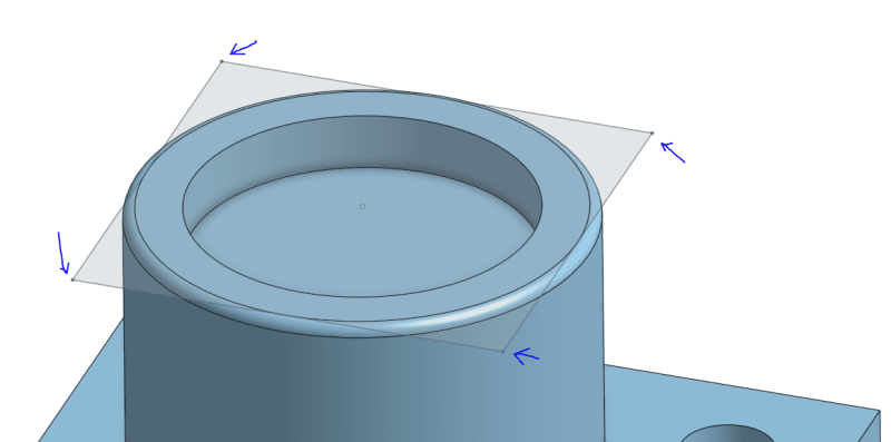

If local size isn't important, you could add Tangential modifier.
BUT, if this is disk shaped, then check what CMM software is doing first.
It can be problematic if evaluates one of the corners blindly:
