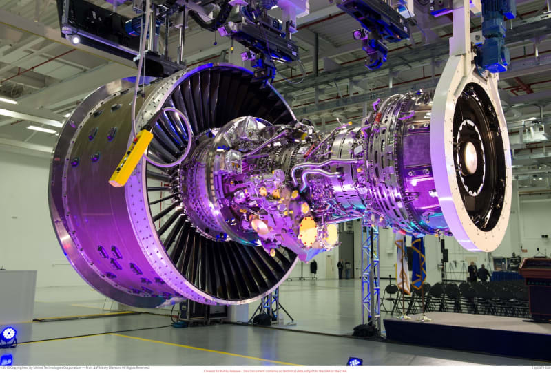

With these engines and the placement of the fadec and permag alternator to power the fadec it is definitely better to stay on the ground.
As you can see on this pic of a NEO engine you have a whole load of fan to scrap away before you get near anything else.

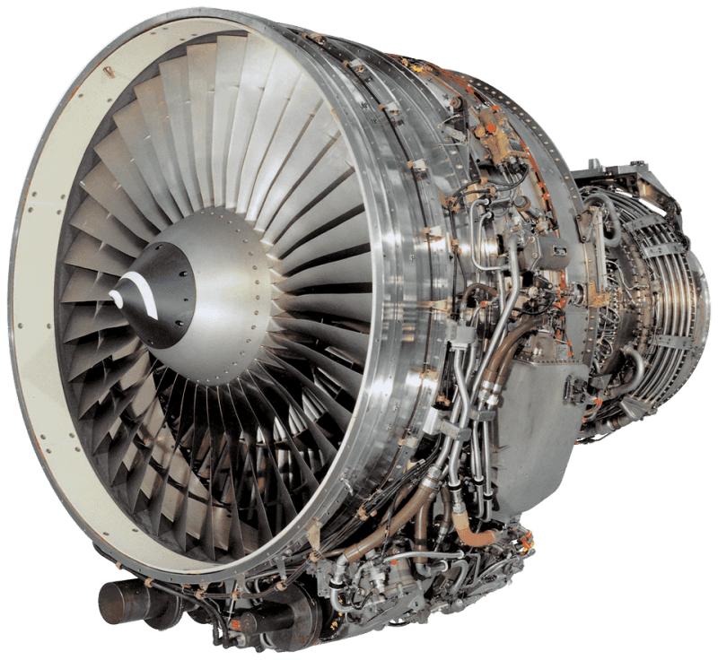

A cm56 is in this pic
As you can see there is a load of important stuff right on the very bottom. And you can easily scrape it off and the fan be serviceable.
The geared fans the fan will be screwed before you get anywhere near killing the aux box and important stuff.
