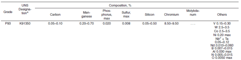

Hello, on last editions of ASTM A335 is include a new grade called P93.
I can see that have Co and Nd (neodimio?)
Anyone knows the use for this new grade? it looks so different from the P91 and P92, so i really don't know what kind of industries needs this new material with Co=2.5-3.5%
Really the addition is Nd or is a mistake and it is Nb (Niobioum)?
thank you

No idea but Googling gave me this (sht 45/50 is on P93): Probably the new kid on the block (although Ive been reading a lot of positive expectations on alloy 740(H) for A-USC power plants).
I don't have a new copy handy, what do they list for a UNS?
K91350
The link by XL83NL has some useful info on the P93 alloy ( AKA Nippon steel SAVE12AD, per asme sect I code case 2839). Basically 30% stronger than P92 at elevated temperatures.
