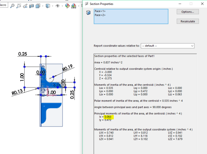

Once you know the shape and thickness, you can estimate A, and analyze using any truss design software. The trick is to get good measurement of the web members (often use non-standard shapes).
Do not design to AISC, design to CISC. Albeit similar, not entirely the same. Depending on the vintage of the joists the angles are likely 300MPa yield.

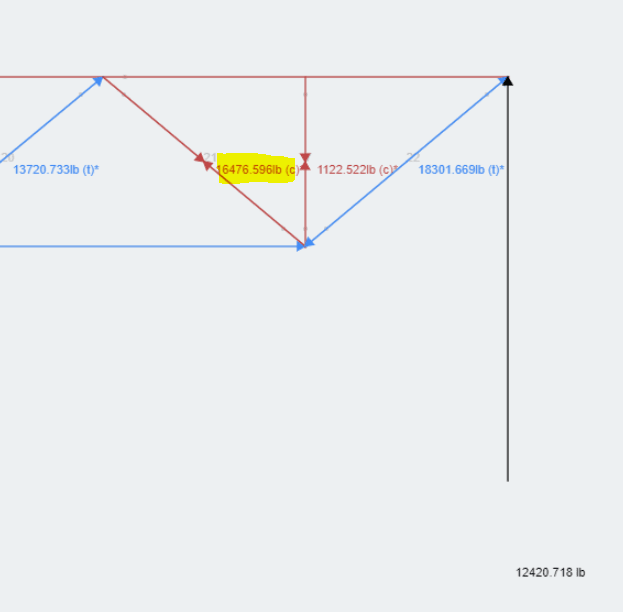

I have gone ahead with my own analysis of the custom joist. Canam has a good reference to the SJI standard specification for joists on their website (I'm using SkyCiv to analyze the axial and bending forces (top chord only) in my members. One end pin and one end roller. As a reminder, these are the member sizes for the 30" deep Warren truss.
Top chord - 3" x 3" x 3/8" back to back angle
Bottom chord = 2" x 2" x 3/8" back to back angle
Vertical web members = 3/4" square bar
Diagonal web tension members = 3/4" square bar
Diagonal web compression members = 1" x 1" x 1/4" back to back angle
Joists are on 6' centers. Loading is as follows
Snow load 41.8 psf which equates to 20.9 lbf/in on each truss.
Roof dead load is 30 psf which equates to 15.0 lbf/in on each truss.
Self weight of the truss. Below is a picture of the displacement along with the reaction forces as a sniff check.
With just these loads alone, I get a peak compressive force in the web angles of about 16 kip (close to the support point as expected). Looking at the slenderness ratio of a single 1" x 1" x 1/4" web angles (length = 46.8in, r = 0.18), it is beyond 200. I'll need to go to site to confirm but I'm thinking these back to back angles must be connected to one another to act as a single member in buckling. If that is the case, and they are spaced 3/4" apart due to the square bar member, the combined radius of gyration for the two members is 0.27 in (I = 0.063 in^4, A = 0.83 in^2). This still leads to a critical buckling stress below 9.0 ksi. Stress in the angles is about 19.0 ksi. Something must be wrong with one of my assumptions if these members are failing so badly under what should be their design loads.

Snow loads can be checked using this link --> It is a gravel roof. Assuming a dry gravel density of about 105 lb/ft^3, it would take about 3" of gravel to get that dead load. Most likely a conservative amount. Even if I decrease the amount of gravel to 1", my UDL on the joist goes to about 4.5 lbf/in. Axial load in the compressive web member goes down to 12 kip and it still fails. My only guess is that I've been given the wrong information on the truss somehow. Regarding skyciv, I'm only using it to get the loads in the members so youngs modulus is my most important input and it's set at a normal 29000 ksi. I am basing my checks on 44 ksi material yield.
Something must be wrong here. Capacity of K-series (ASD):
Yield strength 50 kai
For span = 58', use 30K12, uniform load = 290 plf
For span = 40', use 30K12, uniform load = 438 plf
OP's load = (42+30)*6 = 432 klf. Either the span is way too long, the load way too high, or the measurement is incorrect.
Deener - since I'm in the US (as are many others on this thread) can you clarify to me whether your loads are service level (unfactored) or ultimate level (factored) loads?
I believe those would be service loads, the dead load for sure is SLS level (service). Depending on the location in Canada, I wouldn't be surprised if the snow load was service level as well.
