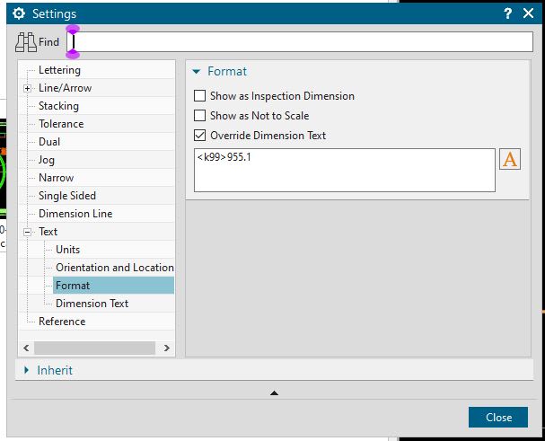

back in my previous job (about 12 years ag)o they had a setting that whenever you manually changed a dimension (override text) the entire dimension would change to a specified color. is there a way to do this in NX 12?
I don't know of any out of the box setting that would change the color of manual dimensions for you. There are check mate tests that will flag dimensions with manual text. They may have customized NX to change the color of the manual dimensions. I wrote some such code years ago that would change the dimension value (manual text entry) and color the dimension to flag it as a "slack" dimension.

When the user manually changes the dimension they can change the color of that dimension.
Below is an example of a dimension changed to 955.1 and <k99> changes its color to color number 99.
<k99>

This may be a thing where the customer would have to set it up by themselves. When we run Checkmate the manually edited dims get flagged and change color on the drawing.
Incidentally, in cases where you want to edit a dim to say something else (like maybe a charted dimension), you can keep it from failing a Checkmate test by adding an attribute to the properties of that dimension. Add a MANUAL_DIM attribute and set the data type to NULL. The dim will show up as an info flag rather than a failure.

There is an old manual test to scan for dimensions with manual text, maybe it's this function Jnikolauk remembers ?
Information - Other - Object specific- Dimensions with manual text.
Overridden dimensions will highlight.
