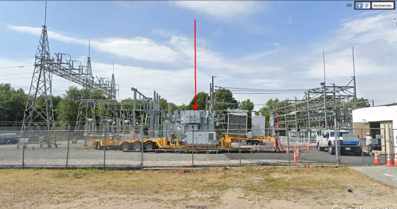

Mobile unit:
I also know what a mobile unit is. We have three of them. I have one installed now in a drop down station..
