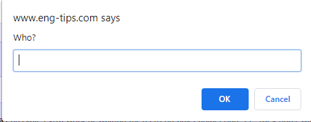

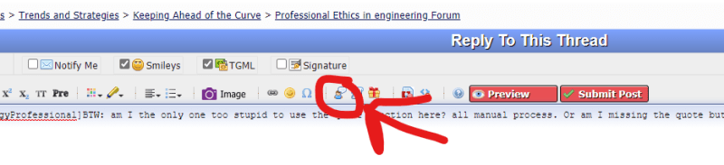

BTW: am I the only one too stupid to use the quote function here? all manual process. Or am I missing the quote button.
that quote button only gives me a pop-up where I have to enter a user name. It doesn't seem to let me quote unless I manually copy/paste. Other forums have a quote (or muulti-quote) button on each post that i want to quote and I can just select posts to quote.
Well, sounds like the architect/owner will get what they paid for. Just sit back and watch it crumble.
Maybe that is acceptable in the Mechanical field, but it is not acceptable in the Structural field, especially with multi-family unit buildings of 15-20 units. That is what I'm asking at; is there any system where someone can anonymously blow a whistle because of some realistic concerns of lack of actual assessment of a project.
If you are, then you're not the only one. I just see a "quote" icon in the text box format area, but I have to manually enter the referenced quote, then insert the actual quote manually (copy/paste).

Last post regarding quoting, yes unfortunately the feature here is rudimentary, you do need to copy paste the text you want to quote. On my laptop not a big deal, on my mobile it's a bit more of a frustration.
