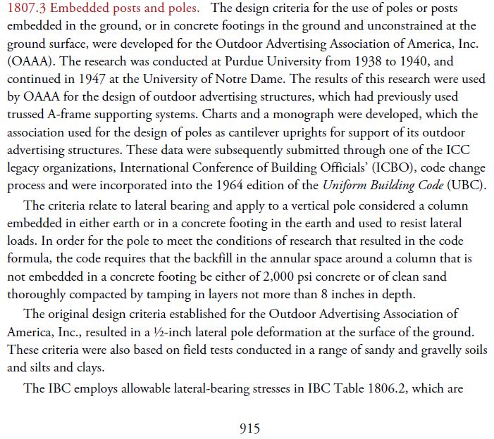

That is strange .. I have 2018 IBS Illustrated handbook and section 1807.3 Embedded posts and poles, explains the development of the formulas. I have copy and pasted the relevant section;
Moreover , i have an old book ( FOUNDATIONS OF STRUCTURES BY Clarence DUNHAM, 1950 ) which has the mentioned nomogram .Pls look attached doc.

At first glance, your excerpt from the 2018 IBC Illustrated Handbook looks like exactly what I’m looking for. I wasn’t aware of this publication. I’m struggling with the definition of (d) for the nonconstrained case:
“d=Depth of embedment in earth in feet(m) but not over 12 feet(3658mm) for purposes of computing lateral pressure.”
In my hunt I’ve found people are interpreting this in at least three different ways (for computing S1):
d/3<=12, d<=12, actual hole depth <=12 ft.
and various other ways they handle it. At this point, I quit looking for the “right” interpretation. Instead I’m looking for the original development in hopes of finding what the author intended.

If i understand correctly , you have problem with the definition of (d) for the nonconstrained case. ( English is not my first language so, if my interpretation does not answer to your question , we may work an examle ).
- the (Equation 18-1) is closed form equation which could be solved mit iteration or with charts ( pls look attached doc. at my first post ), and could be solved with the following steps ;
- without knowing ( d ) an initial assumption is necessary . since the equation is valid for max . d= 12 ft, assume d=12 ft ,
- calculate the S1 = Allowable lateral soil-bearing pressure as set forth in Section 1806.2 based on a depth of one third
the depth of embedment . Look TABLE 1806.2, e.g . Assume material class 4.( Sand, silty sand, clayey sand,silty gravel and clayey gravel ) TABLE 1806.2, S1 will be 4*150=600 (psf).
- calculate the required (d) for this value , and find say 9.0 ft,
- repeat the second step till d= d previous calculated , ( 2-3 iteration would be sufficient )
- or use alignment chart
I hope this respond answers your problem.

I understand the equations are closed form. Their solution is not the problem. I can easily apply any of the three interpretations I have encountered for the caveat in the definition of (d) for the nonconstrained case (S1). I just do not know which interpretation is correct. At this point, the only way to get to the bottom of this is to start with the original derivation. From my other research, I approximated its origin to be in the 1940’s. Your previous post confirmed that(thank you very much!). From it, the calculations were started in 1938 and completed in 1947 at Purdue University. At that point they were adopted by the OAAA. Then in 1964 they were adopted by the Uniform Building Code. Since then, they have been adopted by the IBC, CBC, and others. I find it alarming, everyone uses them, and seems to have their own interpretation of the caveat in the definition of (d). I don’t have a problem with the equations. During their 80 years of use, they have developed a reputation of being conservative. Perhaps that stems from the various interpretations I have discovered. I will continue my investigation. To that end, if anyone has any inside information that helps this effort, I would like to see it.
