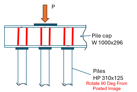

We are designing a steel foundation for a Bailey type bridge system. This will be a permanent bridge. The foundation consists of three piles (HP 310x 125) at each end of a pile cap (W 1000x295). The Pile cap carries load (P) of the bridge. We need stiffeners to prevent buckling of the web and distortion of the flanges of W 1000x295. Question is, what should be the orientation of the diagonal stiffeners (shown in red)? Is it like the one shown on the left, or the one on the right?

Either one will work. It just depends on whether you want to use larger diagonals to prevent compression buckling (for the configuration on the left), or design the connections at the ends of the diagonals for tension and fatigue.
I think most designers would rather upsize the member to handle the compression than deal with the possible fatigue issues. That's what I would do, so I would use the configuration on the left. That one also may have the advantage of allowing you to decrease the size of the exterior vertical stiffeners, or eliminate them altogether.
Depending on the length of the pile cap, it may be more economical to use a heavier cap beam, maybe even a plate girder, that doesn't need stiffeners. Steel is cheap; fabricating stiffeners, gusset plate and connections is expensive.

We are concerned about misalignment due to pile or cap installation error (it's a remote location). There might be eccentricity in load P both in longitudinal and transverse directions. We wanted to prevent distortion of both the flange and the web due to eccentric loading. Moreover, we wanted to make sure that load P gets transferred to all three piles, as one single pile wouldn't generate enough skin friction. These are the reasons for considering the stiffeners in design. Indeed, avoiding them would be cost-saving.

1) Typical tolerance for pile driving is (horizontally) within 75mm of planned location, for each pile. Getting six pile is a (precise) straight line is going to be challenge (even if the pile driver knows what he is doing... using a template).
IMHO, longitudinal pile misalignment is not a big deal... I would consider double web stiffeners at each pile location (shown below).
Transverse pile misalignment is a problem. A partial solution is to rotate the HP 90o from the posted image so that The HP's major axis is resisting transverse eccentricity. (The posted image has the minor HP axis resisting transverse eccentricity.) Another step is to have (and enforce) a "tight" pile driving spec to minimize the problem.
2) Has a geotechnical engineer been consulted? A group of friction piles typically distribute load among themselves automatically... unless deflection is too large. A W1000 supported by closely spaced HP and loaded directly above each pile group will have trivial deflection.
If the piles are true point bearing, your concerns could be valid... but they are not point bearing piles.

I made a mistake in my original sketch. The strong axis should be oriented parallel to the cap, as you indicated.
We have the Geotechnical Report, and the skin friction values are known. We are not relying on end bearing.
We expect the pile cap to behave like a rigid body without significant deflection, and so the three piles are expected to carry equal (P/3) loads, unless there is really bad misalignment.
Thank you for the idea of double stiffeners. We will think about it.

Concerning double stiffeners: Be sure to space them far enough apart to allow fabrication welding between the stiffeners. The spacing is not that important. The load is analyzed as a point load, but by the time load passes thru the bearing plate (thick, with length appropriate for plate thickness), what the beam is subjected to is load distributed over the length of the bearing plate. The distributed load may not be uniform, but it WILL be distributed.
