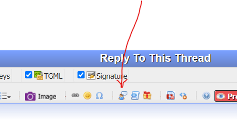

Been on this forum for well over 10 years and still do not know how to "Quote" someone.

@DD
use the indicated icon for quotes

Yes the quotes thing is a bit odd. first copy in the bit you want to quote, then hit the quote button, type in the of the person name, click OK and then where the cursor ends up - between the two ][ paste in the quote.
